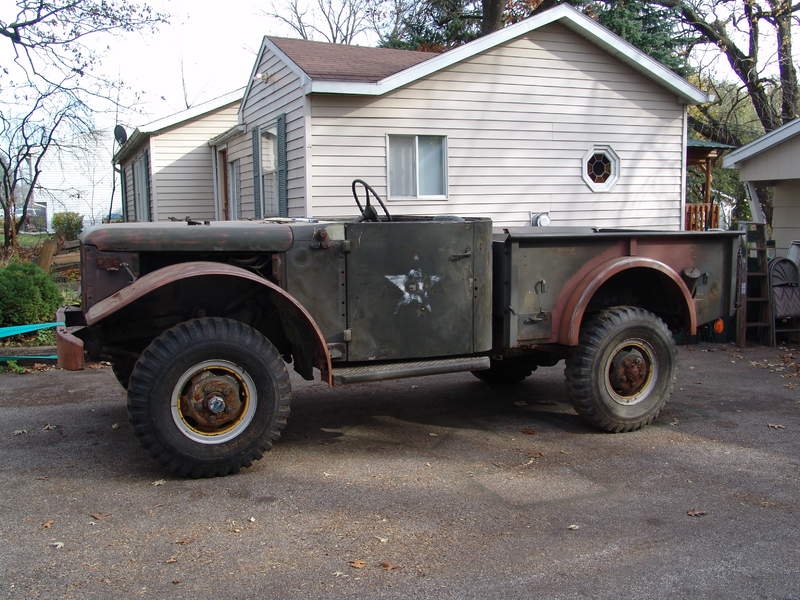

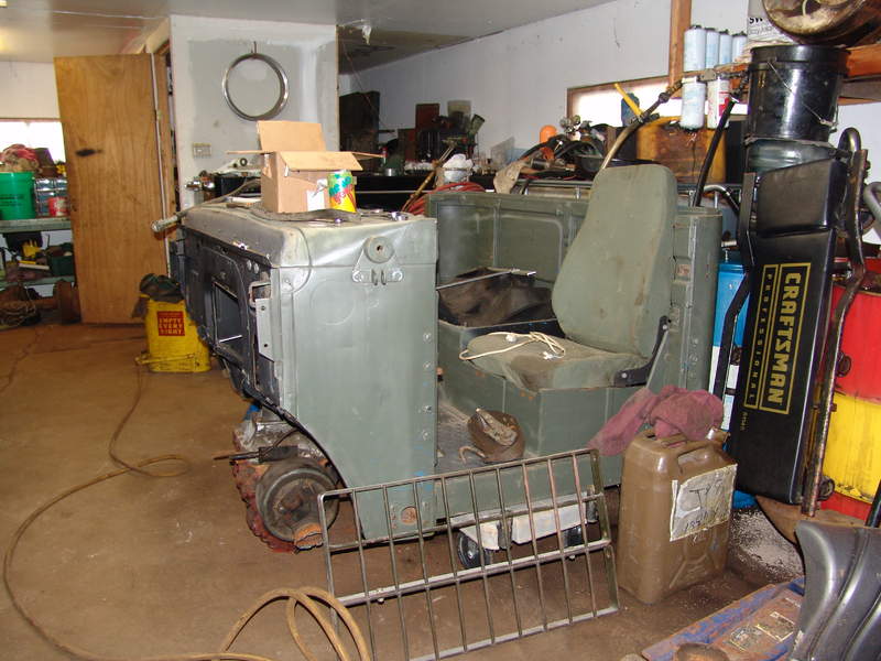

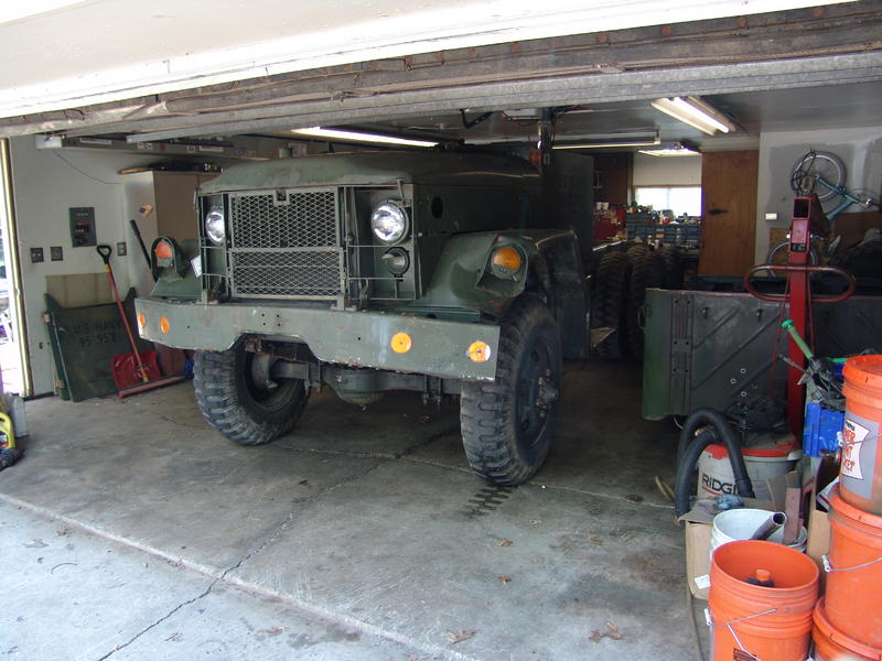

Post by camoyj7 »

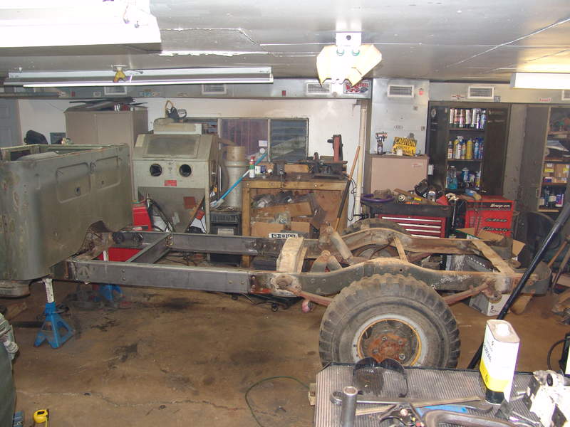

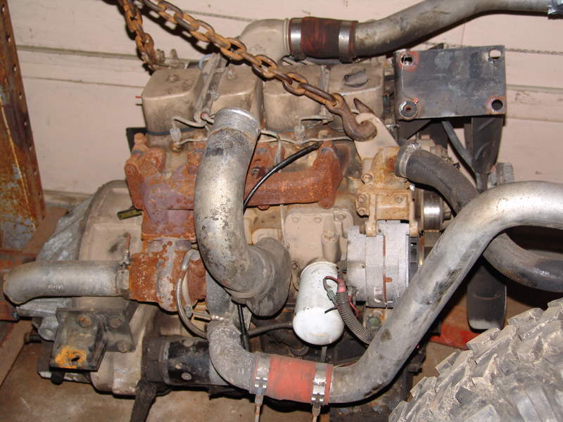

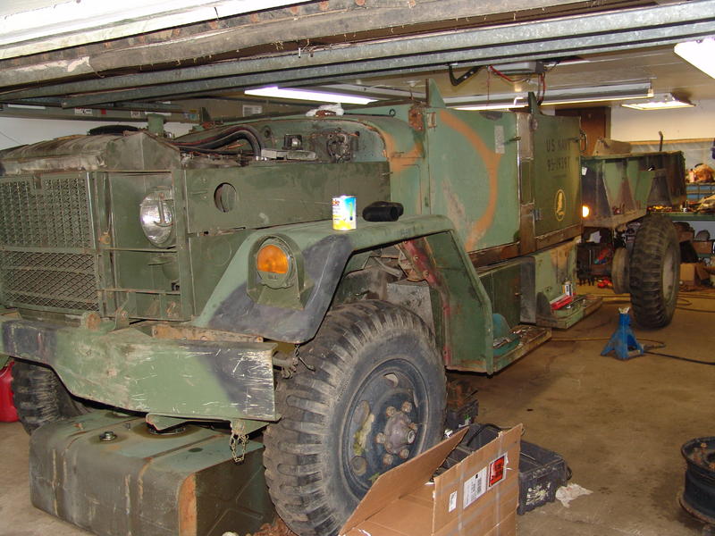

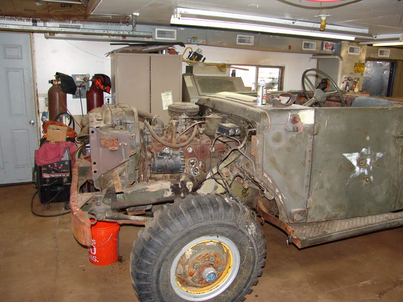

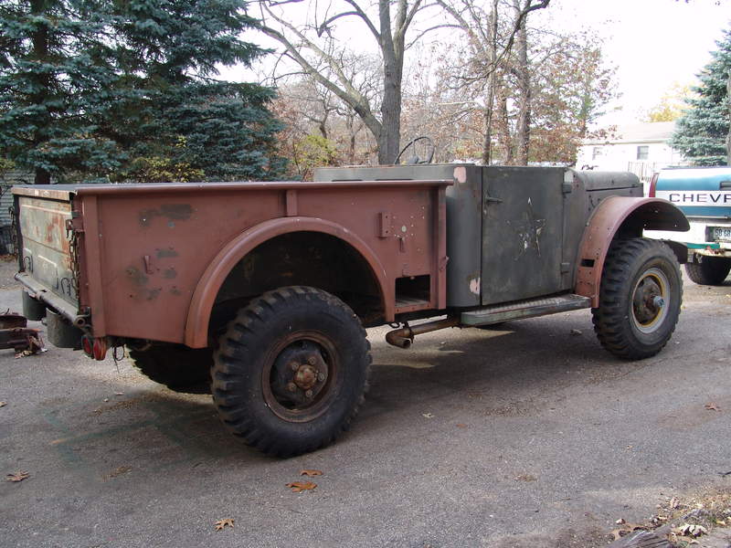

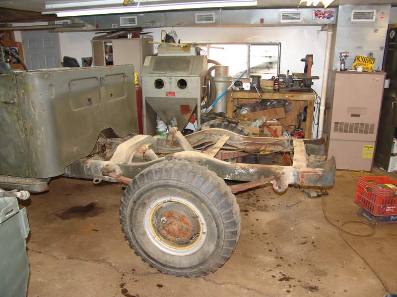

I'm calling it a M37a4. It going to be a 61 M37B1 made into a four door, full size bed, with a 3.9 Cummins 4bt, 5spd, Dana 60 axles, four wheel disc brakes, hmmwv 24 bolt wheels w/37" Goodyears. All late model military stuff led lighting, seats, hmmwv gun turret, ect.

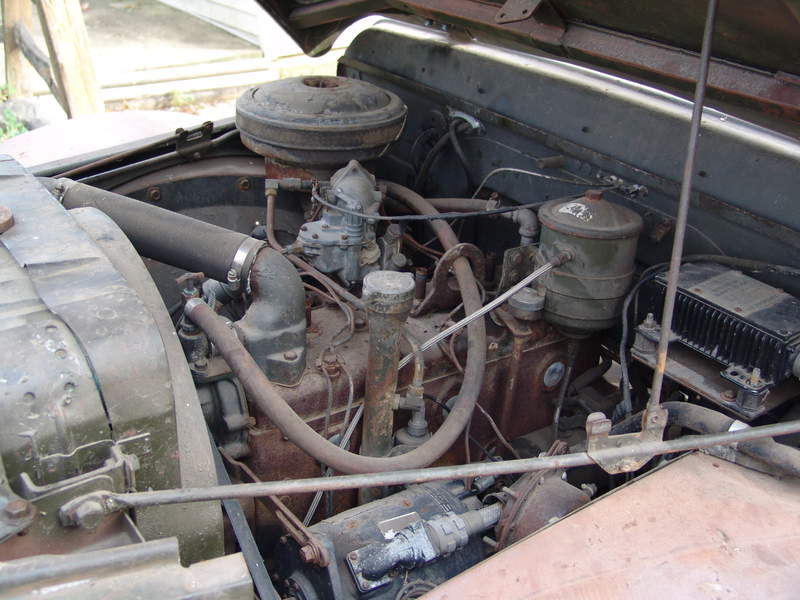

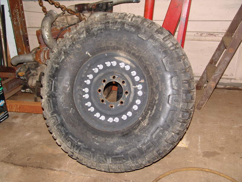

More

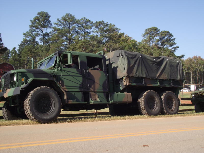

This will be my second crew cab conversion. I did a M35a2 a few years ago in my small garage.

Doing the M35a2 in that garage was a challenge. It's a 7 1/2 tall on the inside not much head room. Because how long it was I had to do the frame stretch out side.

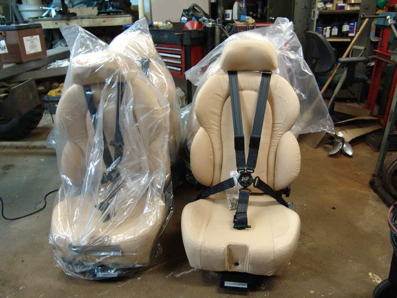

I just picked some new seats for the M37.
W_A_Watson_II
Posts: 628
Location: MO
Re: Project M37a4
Post by W_A_Watson_II »
WOW, those are nice. What brand?
Will
1946 Dodge Power Wagon
My 1953 Dodge M37 WEB Site
camoyj7
Posts: 43
Re: Project M37a4
Post by camoyj7 »
They are MRAP Military GSS COBRA seats.

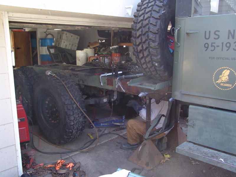

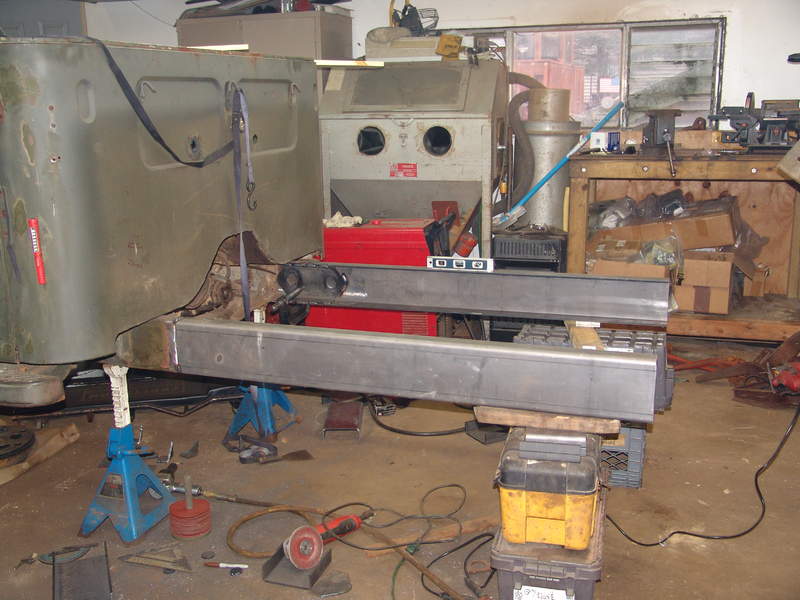

camoyj7
Posts: 43
Re: Project M37a4
Post by camoyj7 »

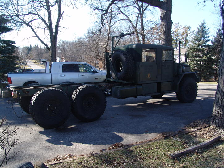

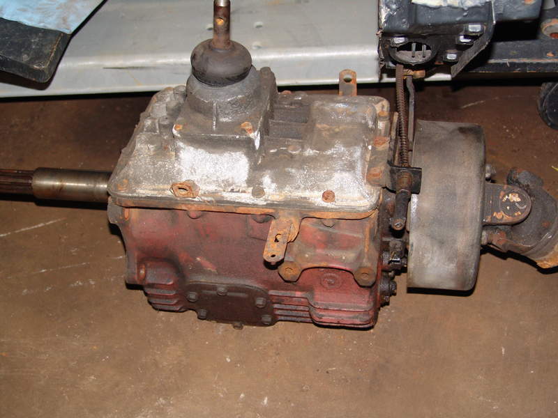

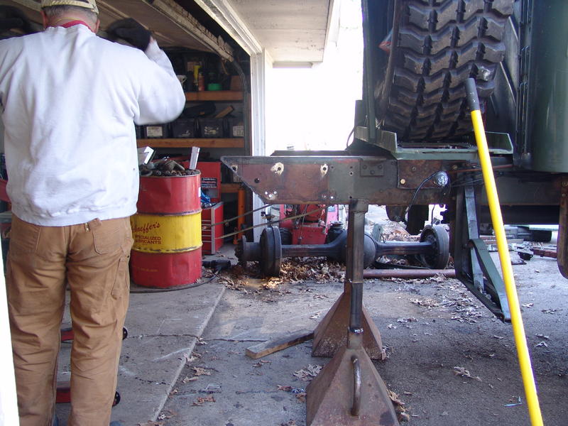

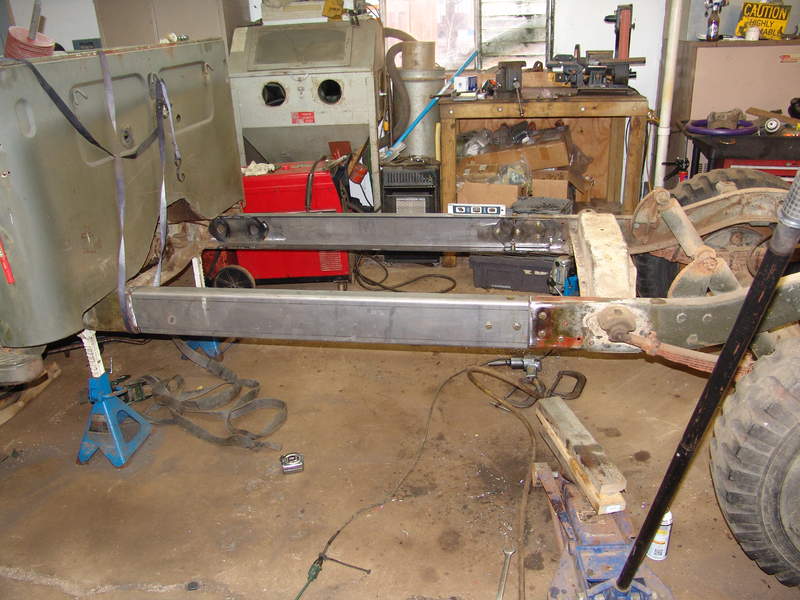

Made some progress today got to cut and stretched the frame. I'm still not sure what the total wheel base is going to be yet. I made the frame extensions a lot longer than I'm going to need so I can shorten them once the crew cab is built. For right now the rear rails are just bolted together. I'll have to notch the new cross member for the driveshaft once I can see where the NP205 will sit.
m37 25.jpg (66.09 KiB) Viewed 17093 times
m37 22.jpg (71.8 KiB) Viewed 17093 times
m37 21.jpg (62.46 KiB) Viewed 17093 times
