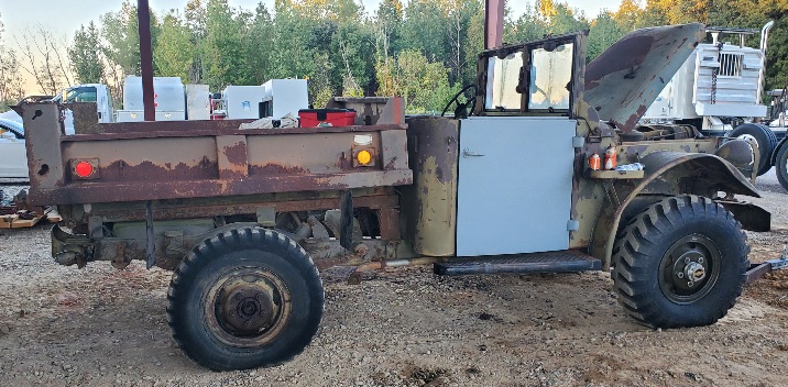

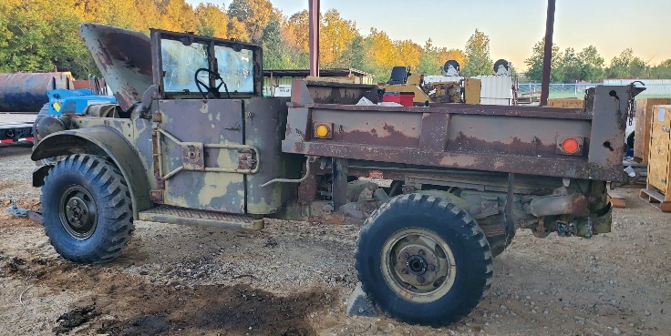

XM708 under roof now
Post by JimC »
Which will make working on it easier.Going to remove the rear tires tomorrow and begin the refurbishing of the rims.

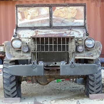

I'm tired of looking at the beat up front bumper, so will install the winch bumperettes for the LU-4 this weekend.

Trial fit today.
Studio_20251019_144519 (1).jpg (62.55 KiB) Viewed 191 times
Re: XM708 under roof now
You might pull one of those bumperettes before setting in the winch. Driver's side. I just did that with mine-too difficult with both in place. You'll also want to slide the PTO shaft in place before mounting the winch as well.
