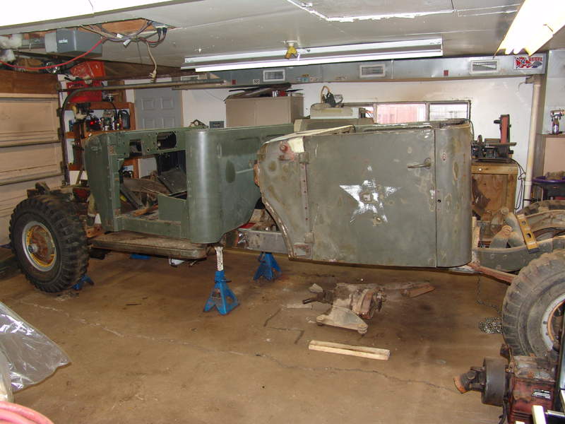

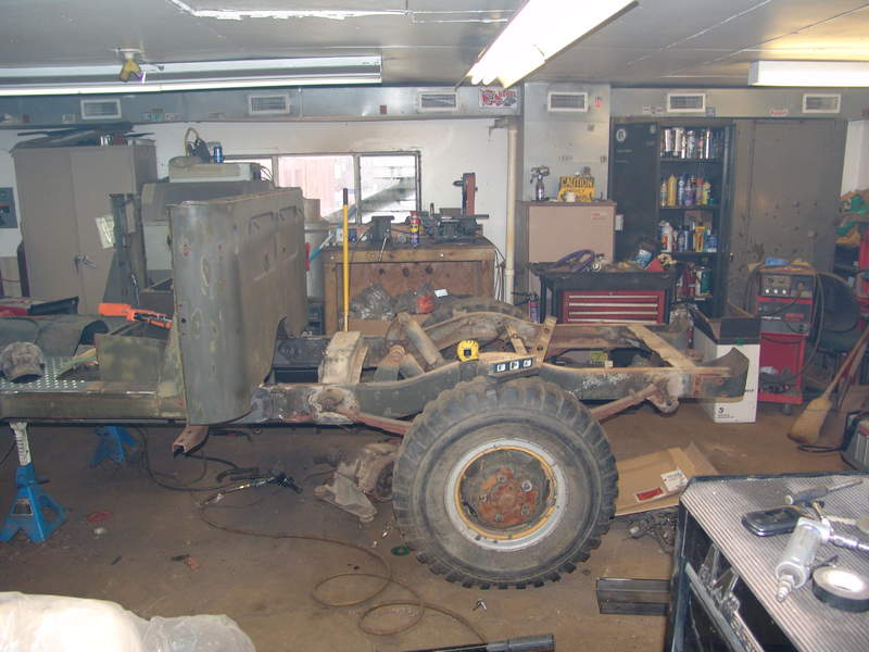

More progress
m37 26.jpg (71 KiB) Viewed 20723 times
m37 28.jpg (61.18 KiB) Viewed 20723 times
m37 29.jpg (55.29 KiB) Viewed 20723 times

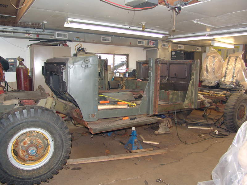

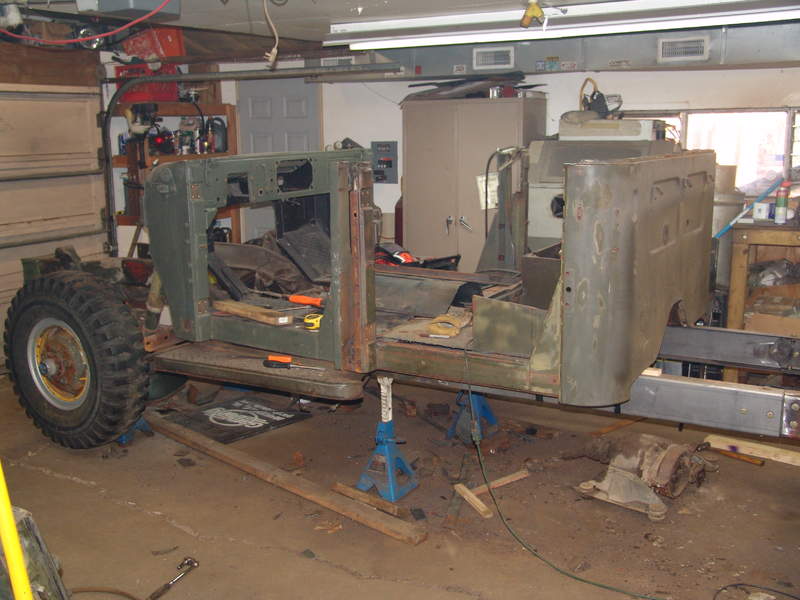

Rough cuts to cabs.
m37 31.jpg (72.68 KiB) Viewed 20717 times
m37 30.jpg (68.11 KiB) Viewed 20717 times

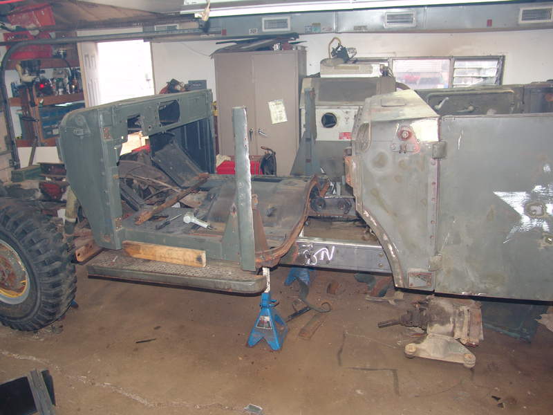

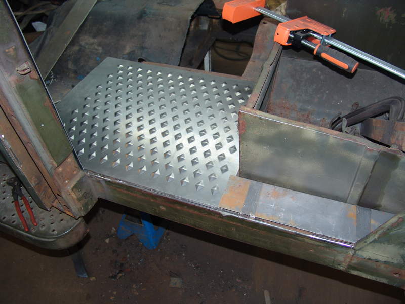

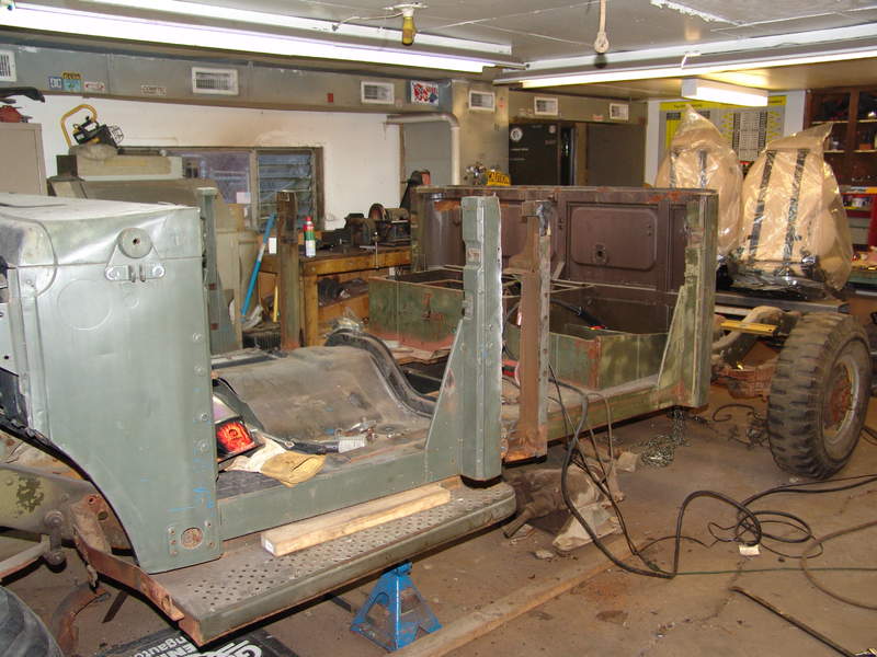

Got the cabs joined up now just need to weld in supports and fill all of the gaps.
m37 32.jpg (58.19 KiB) Viewed 20625 times
m37 33.jpg (68.41 KiB) Viewed 20625 times

It's looking good, mind you, and I am trying not to offend you but with that much length in added to the chassis it's turning radius will be shitful, maybe shorten the front of the tray a bit and bring those rear wheels back in closer to the back of the second cab or were you planning that anyway?
MM
Trained Monkey on Guard
dodgem37@netspace.net.au
camoyj7
Posts: 43
Re: Project M37a4
Post by camoyj7 »
I am planning on shorting the frame that's why the rear half is still bolted together. it looks like I may take out 20" of frame. I didn't know how long the extra cab would be until I had it built that's why I made the frame rails extra long. I'm still going to use the full length bed.

I can't wait to see the final shape, I guess the pictures and their perspective make the truck look overly long, I am sure you know what you are doing and after your large truck project you have all the kinks ironed out....
Keep this pictures coming :-)

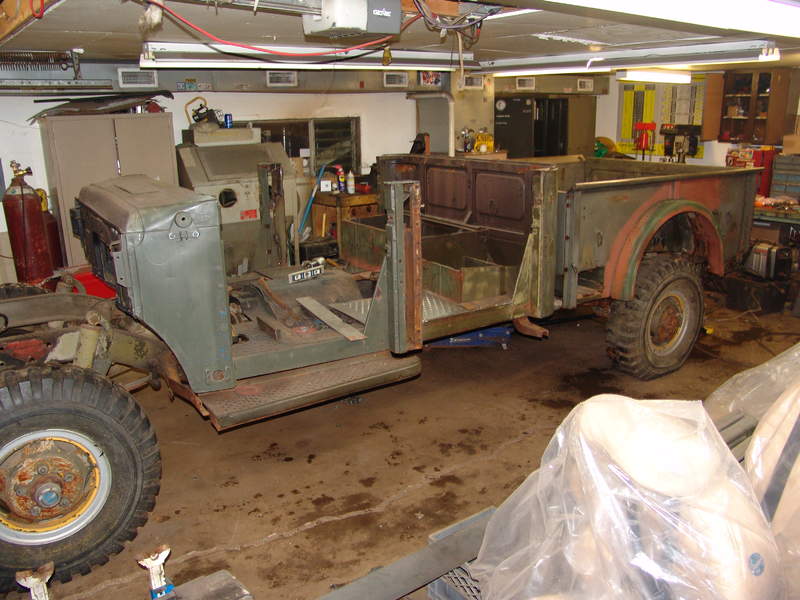

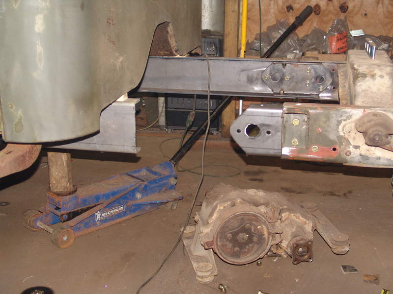

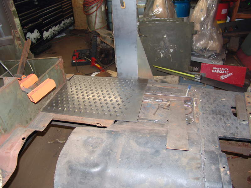

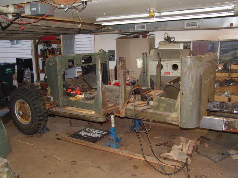

Going to spend this weekend welding supports in cab and try to get new rear floors in.
m37 34.jpg (55.28 KiB) Viewed 20544 times
m37 35.jpg (60.56 KiB) Viewed 20544 times
camoyj7
Posts: 43
Re: Project M37a4
Post by camoyj7 »

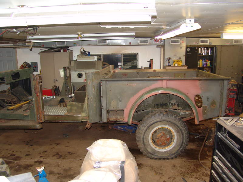

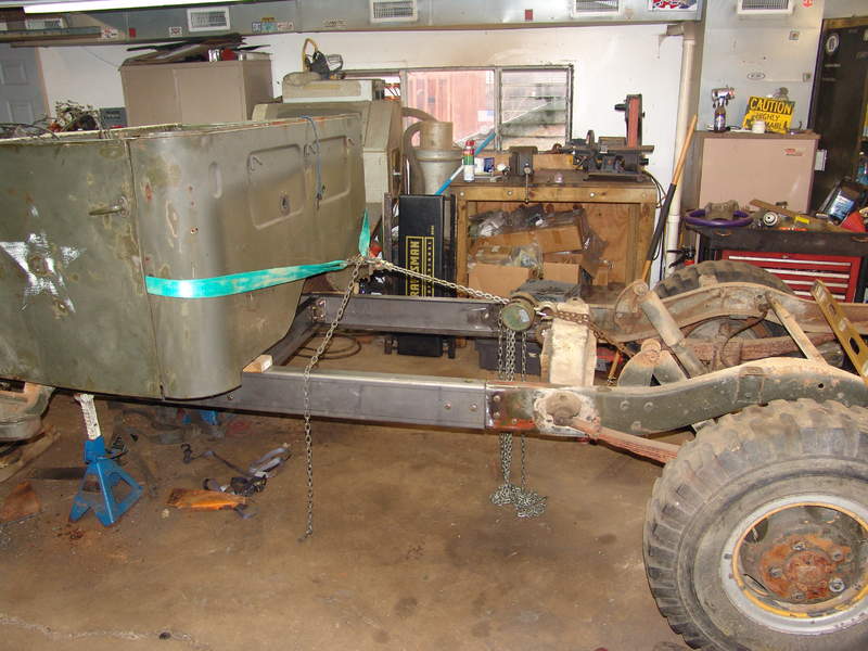

Took 17" out of the frame to get wheel base to match up with the stock bed.
m37 36.jpg (53.87 KiB) Viewed 20524 times
m37 37.jpg (60.36 KiB) Viewed 20524 times
m37 38.jpg (67.23 KiB) Viewed 20524 times

After the stretch what was the actual length of framerail added?
1952 M37cdn
camoyj7
Posts: 43
Re: Project M37a4
Post by camoyj7 »
Ended up being 36 1/2" added to frame.
m37 39.jpg (65.82 KiB) Viewed 20516 times
m37 40.jpg (70.75 KiB) Viewed 20516 times
