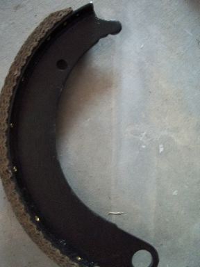

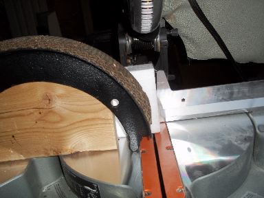

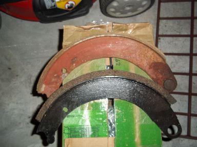

Re: PICTURES!! Got the oversized brake shoes...
3 pictures to show-ready for install.
- ready for install.JPG (13.43 KiB) Viewed 3313 times
- shoe leading edge cut.JPG (20.61 KiB) Viewed 3313 times
- old sshoe vs new.JPG (21.91 KiB) Viewed 3313 times
Hi Gary,
Now that I see the pictures of the brake linings, I understand why you needed to trim them. Thanks for posting them. Please keep us posted on how the adjustment process goes with the new shoes.
