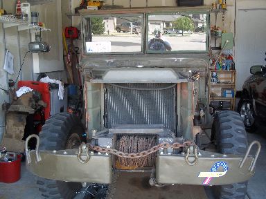

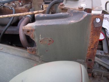

Finally got off my behind and began disassembling my M37's front this weekend, in order to replace the tired front fenders and to repair, prep and paint the cab and everything forward before winter arrives. The short radiator support panels likely have to go too, especially the passenger side-totally rotted out. I'll try to post a picture or two later today. Felt good to get the ball rolling, as I haven't had much time for the M since we bought our fIrst home last year.

- front clip removed 2013.JPG (28.49 KiB) Viewed 3369 times
- radiator support panel .JPG (18.89 KiB) Viewed 3369 times

Today I removed the radiator support panels and prepped the front fender rear braces for removal/replacement-mounts were totally filled with California dirt that settled in before I bought the truck in 2004 so I chipped out the dirt, powered up my wet & dry vac, removed the dirt and hit the bolts with a liberal dose of PB Blaster.
