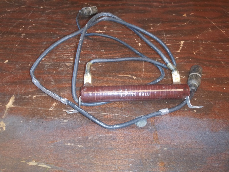

Posts: 1282
Re: Wanted: Hot Water Heater Wiring.
This is the resistor.
Pat Gray
Posts: 61
Post by Pat Gray »
Thank you, Is it a common part?
Thanks, Pat
Posts: 1282
Mouser or Digikey
