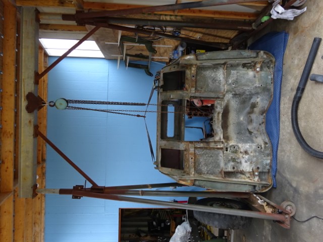

Re: cab on its back?
DSC01112 (Small).JPG (118.88 KiB) Viewed 1797 times
Used this method. Kept tension on the hoist.

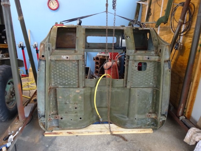

DSC01117 (Small).JPG (125.87 KiB) Viewed 1797 times
cleaner, now to kill the rust.
What rust? I wish my cab looked that good... :)
