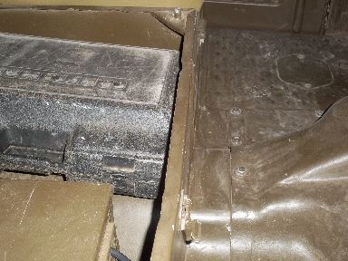

On this topic...can anyone show how the passenger seat bottom is supposed to stay in position? My truck came to me half dilapidated, I cant figure it out!

I can't post a picture, but on my trucks, there is a stud on the front passenger side corner that fits into a matching hole in the plywood and the latch on the front of the seat to hold it in place. Maybe someone else can post a picture to show what and where. If yours has nothing left, it would be easy to figure out something similar.

Well timing is everything-I was just posting my front clip pictures and saw this post so I headed to the garage and snapped this one-mine has a single stud (top of photo), and the latch in front.
pass seat cushion latch and stud.JPG (27.1 KiB) Viewed 2008 times

Cal_Gary wrote:Well timing is everything-I was just posting my front clip pictures and saw this post so I headed to the garage and snapped this one-mine has a single stud (top of photo), and the latch in front.
Thanks! I have that little latch...it just presses into the bottom on the seat cushion then? I will have to see what I can do when the seat gets back from being re-covered. I worry my seat bottom may be too worn out!

No, there is a little metal latch attached to the seat bottom that the spring clip looks onto. I don't have one so I can't post a picture.
