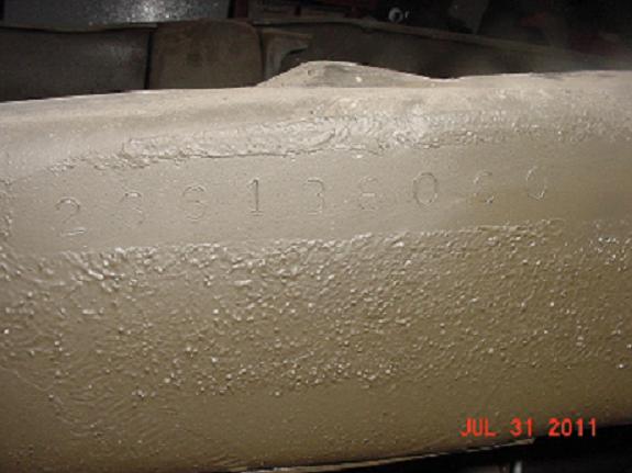

SN on Frame.......Kinda hard to tell from pics........
Frame SN.jpg (35.34 KiB) Viewed 3659 times
Rod
Re: Serial Number Help
Looks like 236138060 to me....

Cal_Gary wrote:Looks like 236138060 to me....
it could be it is real hard to see those middle numbers.......I am going to try that and see if it works....thanks
Nope........didn't work.... :?

Post by m-11 »
Looks like 266138060
