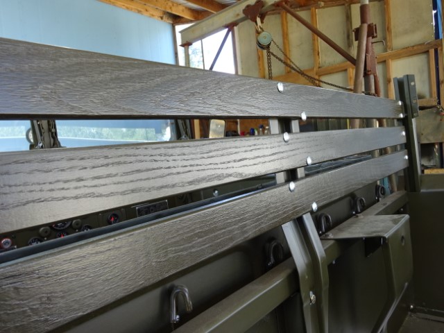

Some Oak painted. 2 coats of Thompsons water seal and 3 coats of OD.

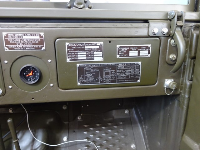

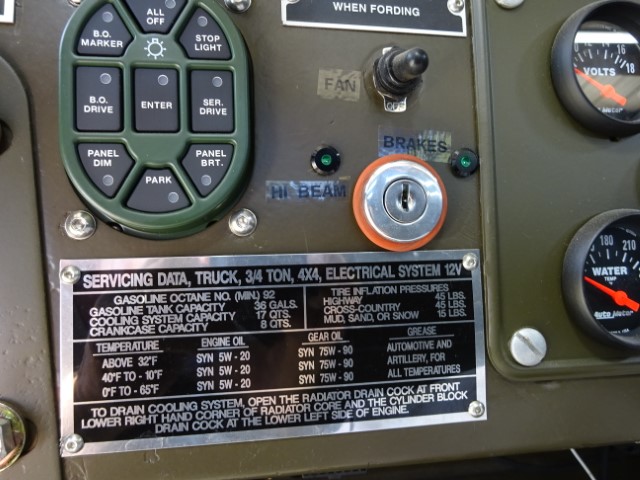

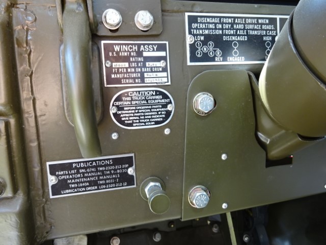

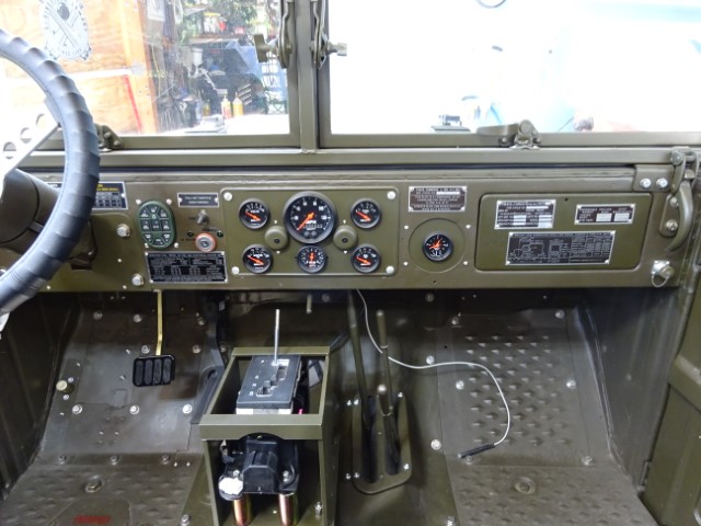

Some dash pics.

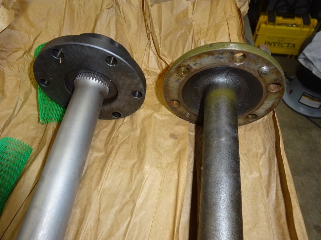

Re: 1954 M37 rebuild thread
DSC01686 (Small).JPG (104.89 KiB) Viewed 10063 times
DSC01685 (Small).JPG (104.7 KiB) Viewed 10063 times
DSC01684 (Small).JPG (113.81 KiB) Viewed 10063 times

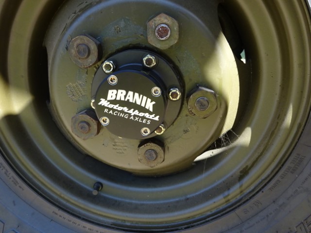

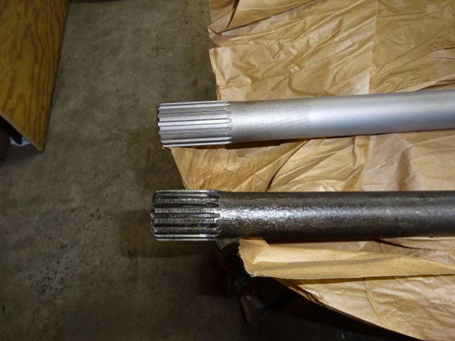

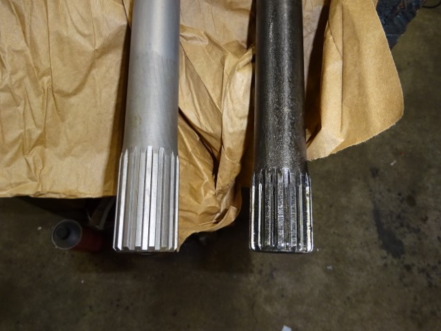

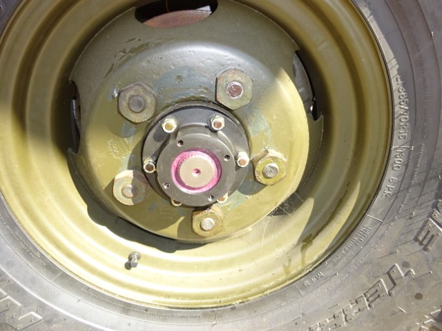

Putting in my new axle shafts.
DSC01687 (Small).JPG (123.02 KiB) Viewed 10063 times
DSC01688 (Small).JPG (118.03 KiB) Viewed 10063 times
DSC01689 (Small).JPG (101.98 KiB) Viewed 10063 times
More pics. The hub is steel, with a cap of aluminum. The shaft has a spring clip in the notch at the hub end.

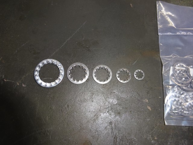

Those 7/16" washers on the dash...are they split lock washers or something else? I'm still figuring out what to do now that the periphery washers are unobtainium.
M37
YEAR: 1954
greeno wrote:Those 7/16" washers on the dash...are they split lock washers or something else? I'm still figuring out what to do now that the periphery washers are unobtainium.
Those are thick grade 8 flat washers. I didn't use split lockwashers, I relied on locknuts and locktite where necessary. I used a few mars washers (what we called them years ago- don't know why) on the smaller bolts(like on the door).

I also used these in places.

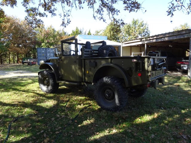

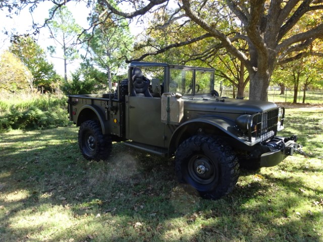

DSC01693 (Small).JPG (154.61 KiB) Viewed 9901 times
DSC01692 (Small).JPG (174.53 KiB) Viewed 9901 times
DSC01691 (Small).JPG (179.18 KiB) Viewed 9901 times

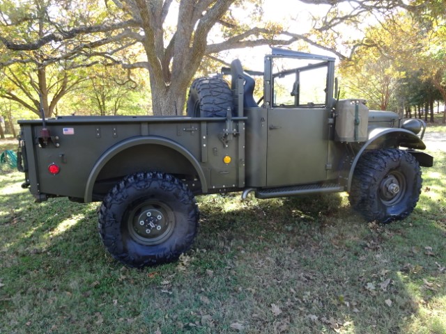

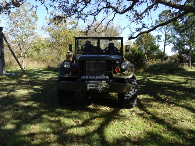

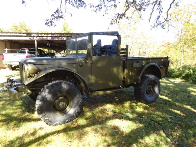

It is alive! drove it a couple of miles, nothing fell off- or drained out! everything seems well so far, having some TC shifter issues-probably adjustment issues.

I'm curious: was there a problem with your old axles, or were you just worried about them for the future?

with the 375 HP hemi I figured that I maybe needed something stronger, having heard so many stories of the oem ones breaking- with the stock driveline. Granted, I have heard of the people who have never had a problem. For me it was just good insurance. The axles I removed were perfectly fine.

Makes sense. I missed the part about the new engine.
