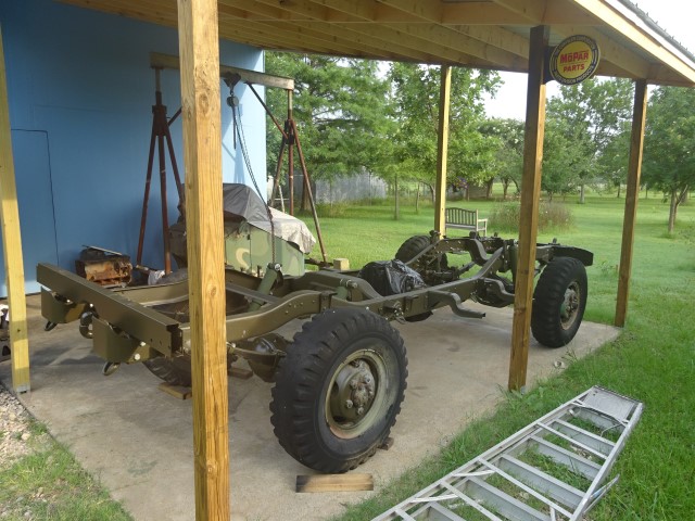

Some pics,

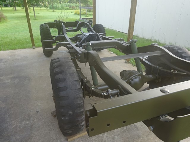

Re: Frame just about done.
Nice job on your frame, going to be a nice truck!
good looking foundation for a fine truck.
Yep, wish mine looked like that. Nice job!
Posts: 1822
The frame is looking good, can I ask why you are using hitch pins instead of bolts on the leaf spring keepers?
T. Highway wrote:The frame is looking good, can I ask why you are using hitch pins instead of bolts on the leaf spring keepers?
I used poly slide between the leafs, and could not get a bolt thru the hole!

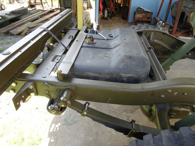

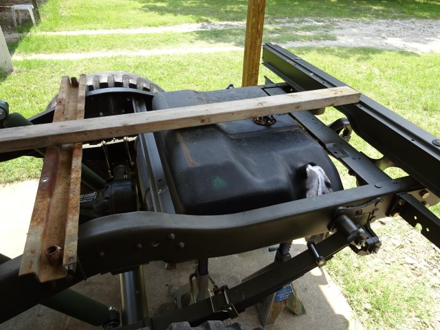

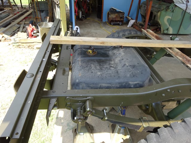

Fuel tank fits!
This came out of a Dodge Ramcharger- 35 gallon poly tank.

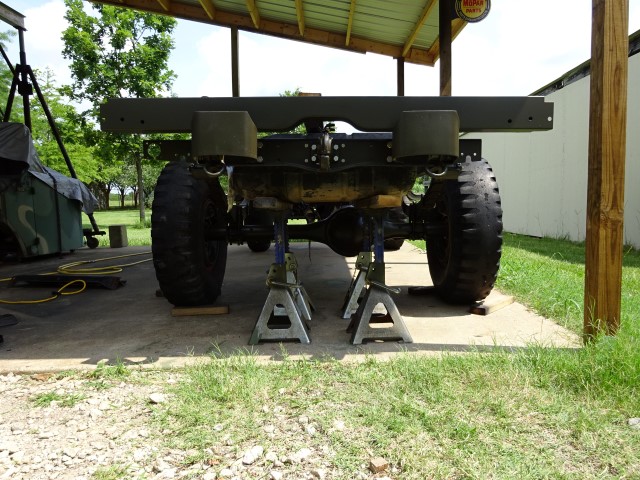

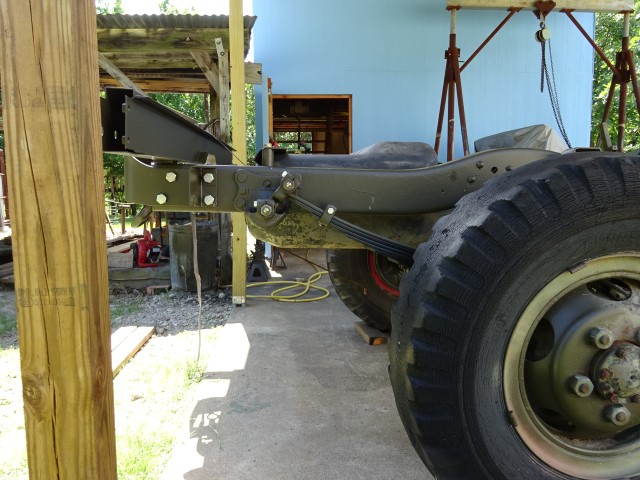

Three more pics.

Re: Fuel tank fits!
That is way cool.
Re: Fuel tank fits!
I think that is going to a popular "upgrade." Maybe you can post how you did it some time.

Re: Fuel tank fits!
Post by W_A_Watson_II »
Very nice!
I used a Bronco 33 gallon Poly tank on the PW. The tank is 15" tall, rather than the 12" of the stock tank but I was able to fit it nicely, just no potential of a rear PTO with it.
Will

Re: Fuel tank fits!
Great upgrade guys, what was the model year for these tanks? I'm sure others would need to know that if they plan on doing this.

Re: Fuel tank fits!
I don't know the year range, but the Bronco tank I used in the PW was a MTS Plastic Bronco 33 gallon fuel tank (425C1) with an MTS Bronco Sending Unit (73E/10F).
Will
1946 Dodge Power Wagon
My 1953 Dodge M37 WEB Site
Re: Fuel tank fits!
T. Highway wrote:Great upgrade guys, what was the model year for these tanks? I'm sure others would need to know that if they plan on doing this.
The Ramcharger tank was a '78-'92 deal, the later tanks had the in tank fuel pump. When looking for these at salvage yards, note that they were also equipped with 25 gallon tanks. My tank is a non pump tank part # 4279528.

Re: Fuel tank fits!
Outstanding, Thank You both.
