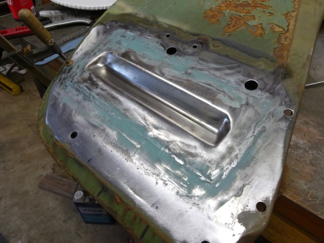

I hate welding!-- 'cause I don't know what I'm doing.
Re: 1954 M37 rebuild thread
That doesn't look bad, 06. I recall an old post here where Charles at M-Series posted a "how to" for plugging the reinforcement plate underneath to keep water and debris out of the gap.
P.S. Here it is! http://www.g741.org/PHPBB/viewtopic.php ... l&start=15

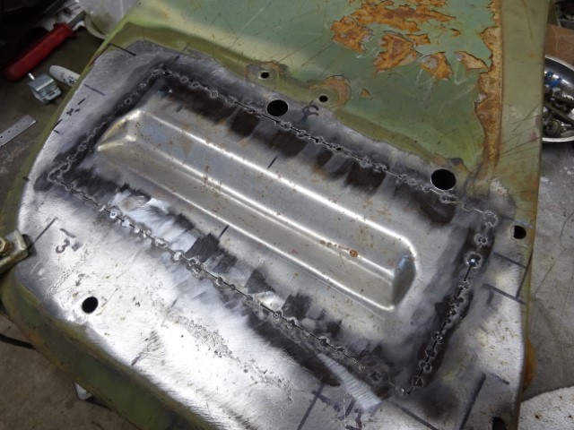

DSC01344 (Small).JPG (116.12 KiB) Viewed 2693 times
all welded and starting the smooth out. I now know what warping is.

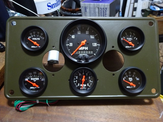

new instruments
Your cluster turned out really nice!

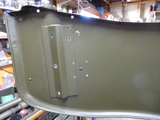

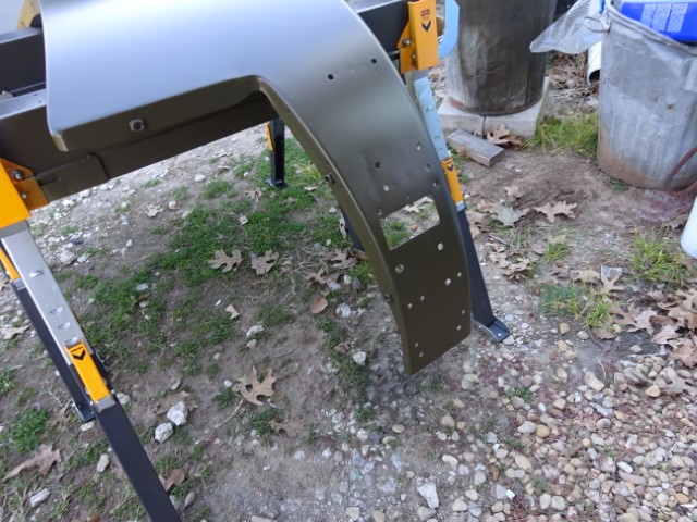

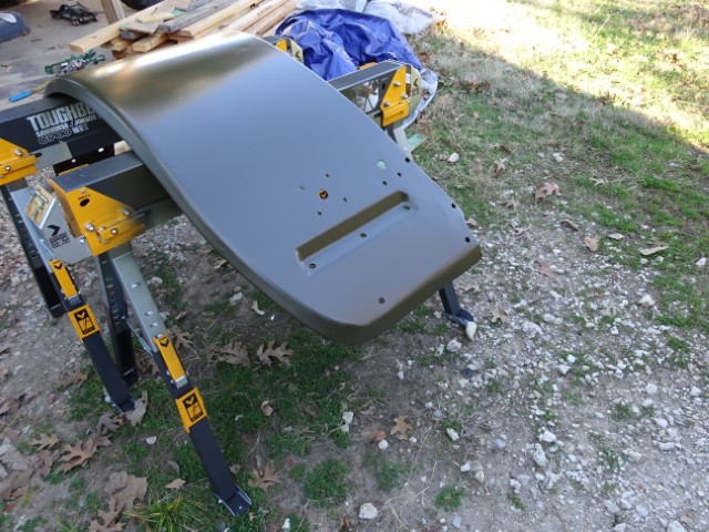

DSC01356 (Small).JPG (109.71 KiB) Viewed 2600 times
DSC01358 (Small).JPG (97.95 KiB) Viewed 2600 times
DSC01357 (Small).JPG (100.59 KiB) Viewed 2600 times
More pics of the fender.

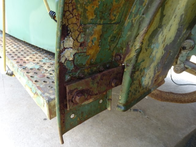

these pieces I had to grind off the 4 rivits holding them on the fender so I could clean up the rust between them
DSC01359 (Small).JPG (117.47 KiB) Viewed 2600 times

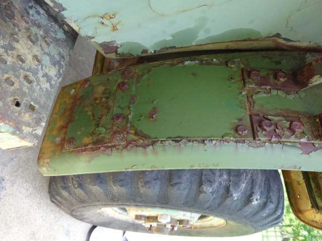

This is what the rear of the fender looked like before
Both of my front fenders were like that, I found a NOS driver's fender at VPW , it was worth it.
Managed to repair the passenger side.
Your work is outstanding, concours looking!!
