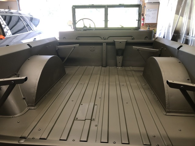

Finished painting the bed with my secret recipe.
M37
YEAR: 1954
Re: Grandpa’s M37
Outstanding, looks great!

Re: Grandpa’s M37
Post by RCrombie »
Sigh.... I wish my wheel arches were that clean

Thanks. There is a ton of hammering in those. I think I tore it down just in time to stop the rust worms.

Looks like it's coming out of the producing plant right now! :shock:

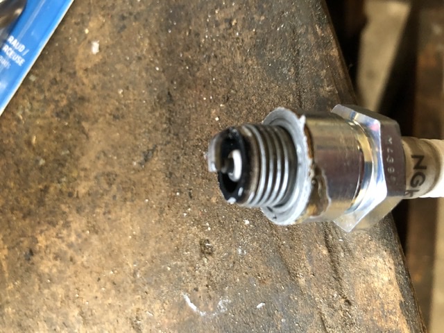

Took a 6 mile trip to the gas station this am. First trip in traffic. Ran fine. Didn’t make too many people mad by my slowness. Pulled the #1 plug looks ok.
M37
YEAR: 1954
Re: Grandpa’s M37
"reading" plugs is somewhat of a lost art. A few minutes of idle can really soot up a plug, One thing we can look for is a very overheated plug, or broken ceramic or bent/melted electrodes. When I pull my plugs for any reason, I use mew copper compression washers, I get them in various thickness from Jegs, used for "indexing" spark plugs. Plus anti seize and use a good torque wrench. Important to use the proper heat range too. I think "heat range" actually refers to the ceramic insulator, a bit longer to project more into the combustion chamber to burn off deposits better, ie, a hot plug, and for a cold plug, a shorter insulator.
