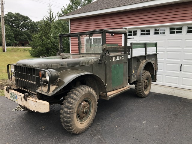

Got the truck back to the house yesterday, power washed it today and pushed it into the garage. The garage I built to restore the M37, so I guess I’m $35k into my resto already!
Right now I’m thinking about where to take this project. The metal is in good shape and the engine ran a few years ago. My dream is to drive it in parades, so it doesn’t need to be show quality just reliable and serviceable.

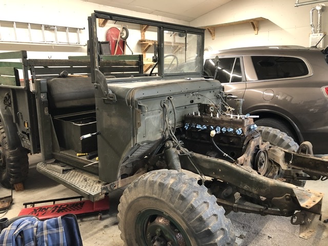

Kids and I got a lot of wrenching done. Already sick of fine threads.

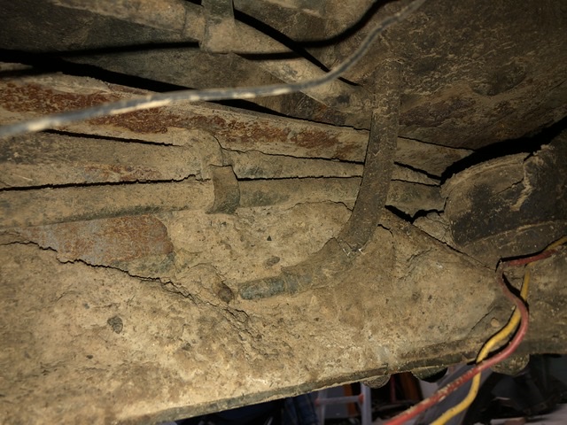

Anyway, took photos of mud tonight:

Man you got some mud!

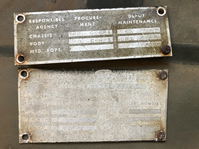

Found the original color. I like it, but I am considering Marine Corp paint, pops did a tour as a demo expert in Vietnam with the Corp. That said, grandpa was in the Navy... Posting the numbers here too in b case I loose them ;)

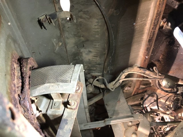

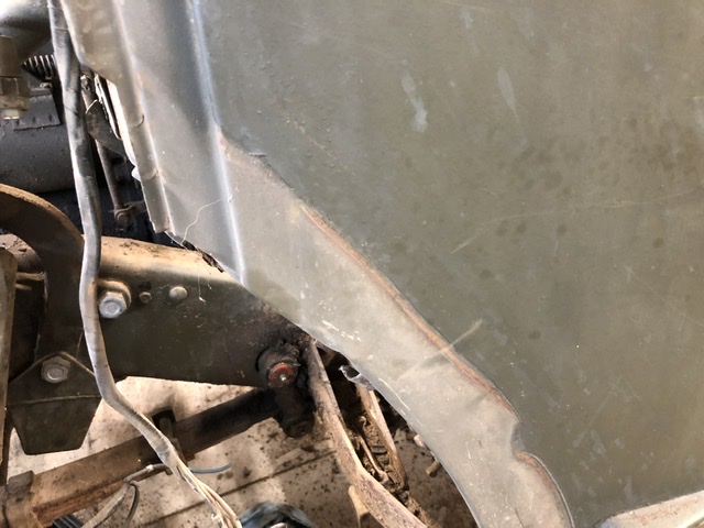

Found some rot, no surprise here.
Also pulled the water tube. Use a flat bar and push it in to loosen, then pull out. It was a struggle for sure.

RCrombie
Posts: 164
Location: Ottawa, Canada
Re: Grandpa’s M37
Post by RCrombie »
Those water tubes can put up a fight coming out. I don’t know if they are available for the 230, but the longer 251 engine uses a brass tube which doesn’t corrode the way the steel ones do.
And if the flange around the fresh air vent is the only rot you have found so far, I would say you’re doing alright!
Re: Grandpa’s M37
John at Midwest has the coolant tubes-stainless steel, and includes the hook for fishing out the old remnants.

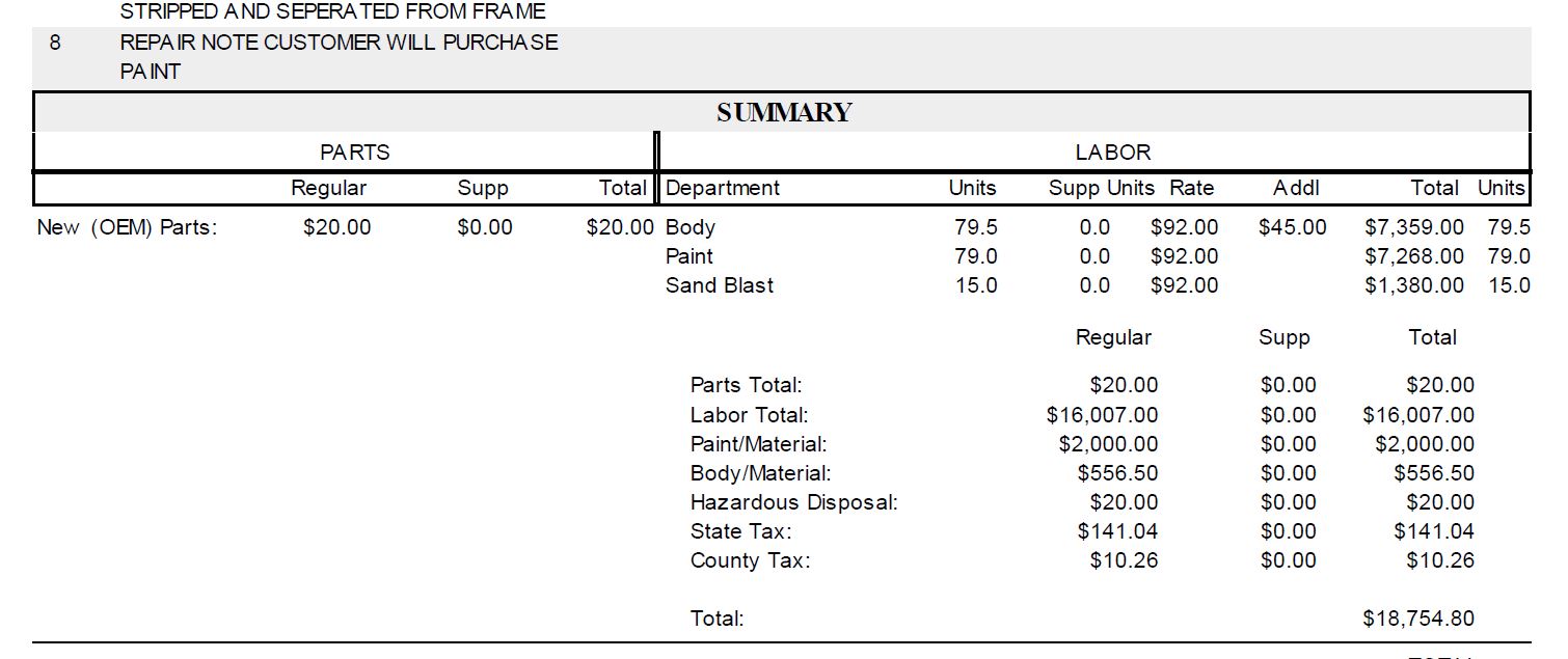

Uh, I think I called the wrong shop. Or they don't want the business.

RCrombie
Posts: 164
Re: Grandpa’s M37
Post by RCrombie »
Um...
Uh......
I guess they really hate sandblasting and painting?

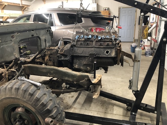

It’s hunting season so I’ve spent little time in the cave. Got the engine out. What’s the engine weigh? I’m not in love with my engine stand.
