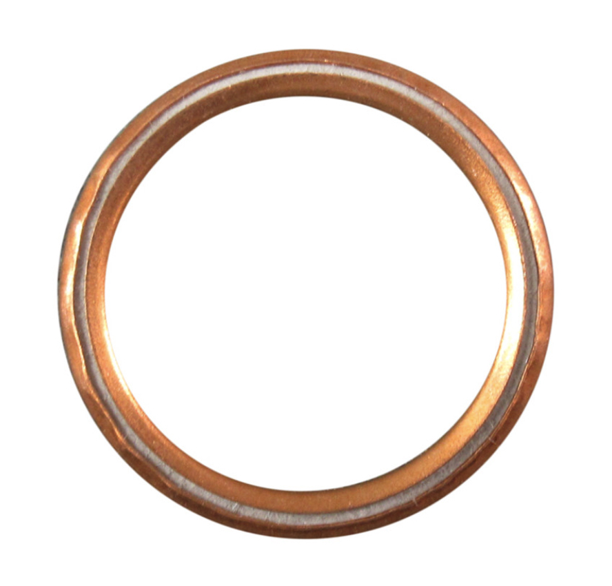

Mil-spec copper/asbestos (or whatever the modern substitute is for asbestos...) MS35769-18 (7/8" ID).
Available from places like skygeek.com, etc.
Skygeek MS35769-18.jpg (237.29 KiB) Viewed 5098 times
