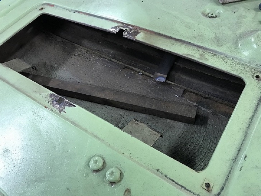

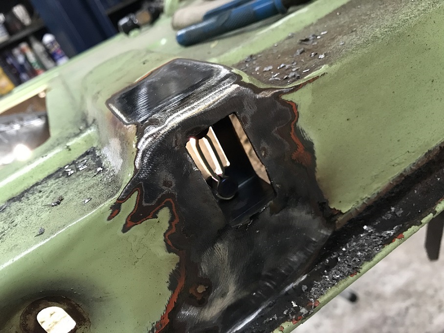

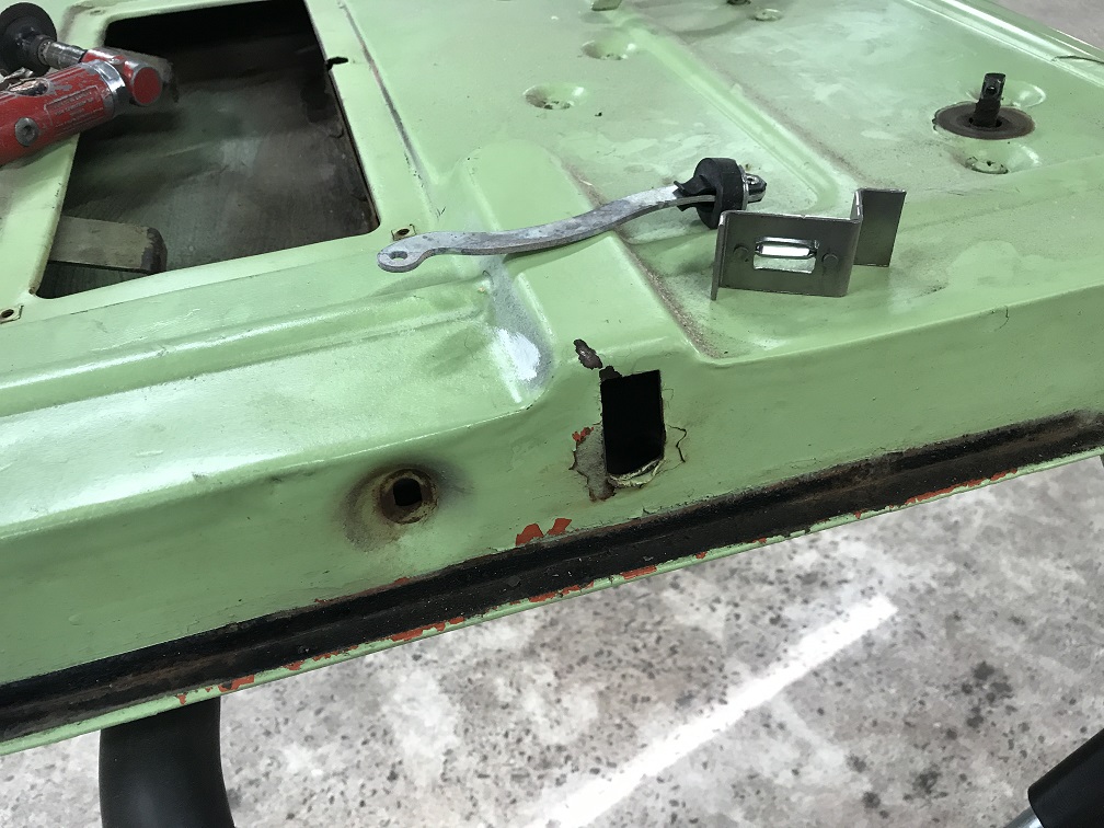

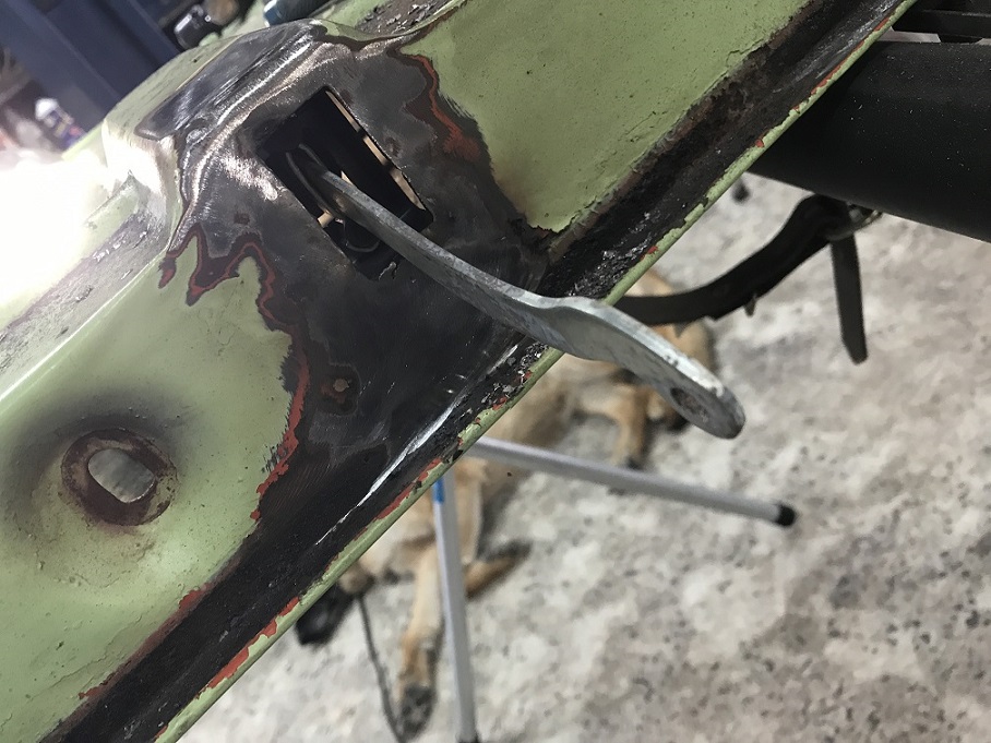

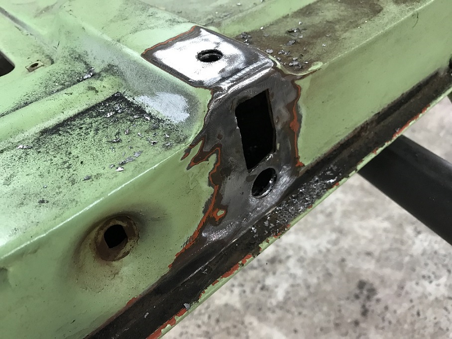

Here are a few pictures where i replaced the door catch. Both doors were the same with it all tore up and missing. The hardest part was getting the old brackets from inside the door as they are welded in. I made a long chisel out of flat bar which helped some and used the angle grinder to sand away most of the metal. inside the door. Then i drilled 2 holes to be able to plug weld the bracket in place. Welding inside the door would be tough. After plug welding, just sanded smooth, ready for primer

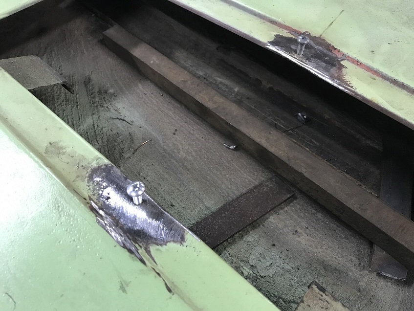

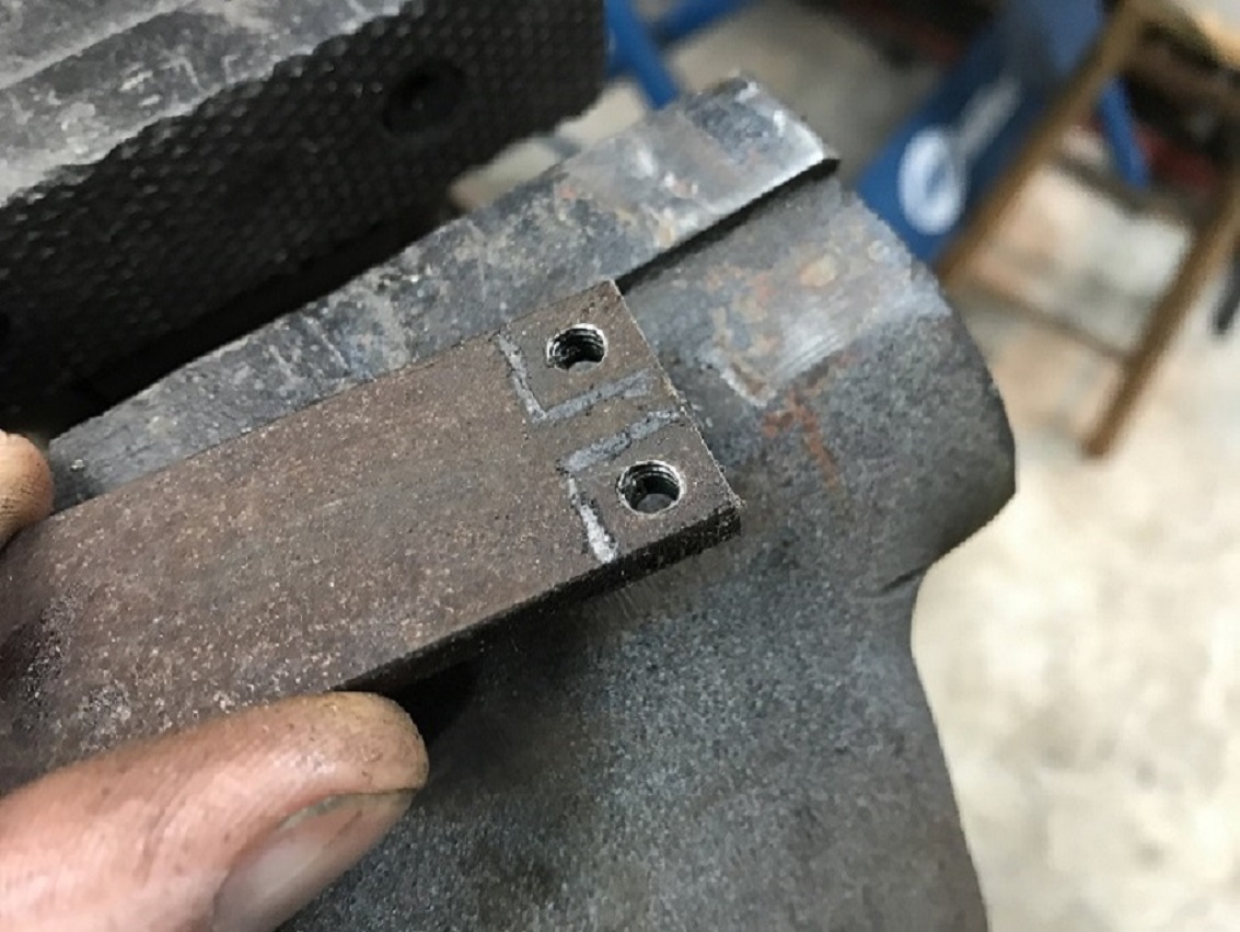

Here is where I fixed the threads for the inside door panel cover. Several holes had the little threaded sqaures pulled out. I just made new ones and welded in place.

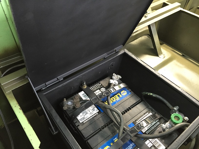

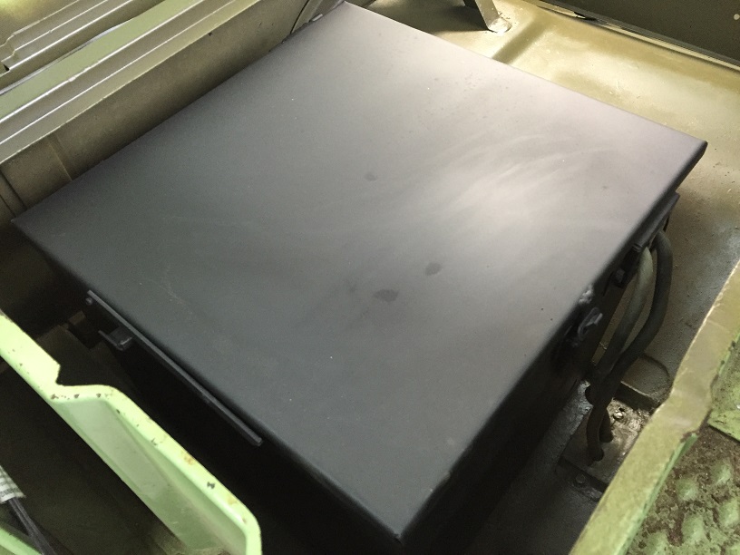

Battery box lid was missing. Here is new one i made with little arm to hold up. Since that picture Ive replaced the battery terminals with the permanent ones, used those at time cause had them.

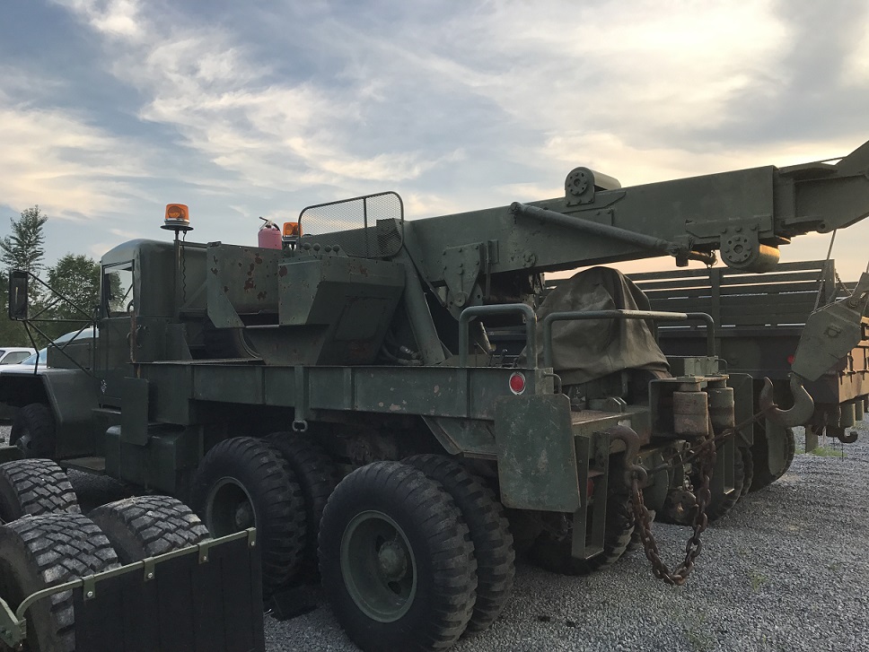

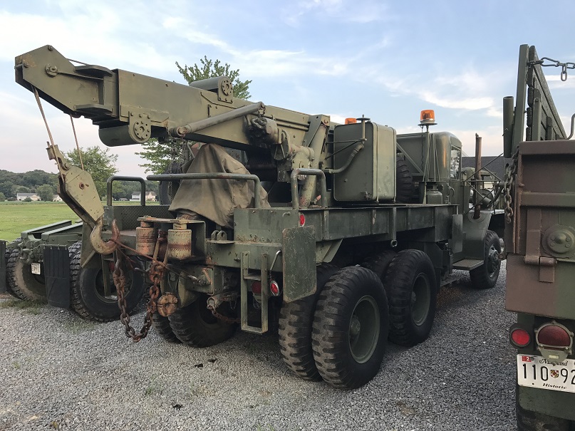

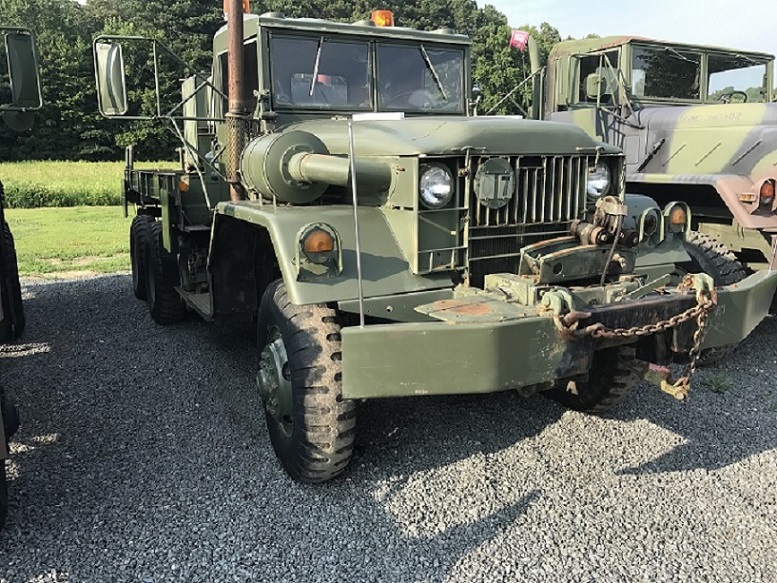

Not an M37 but cool truck anyway. Just got it this past spring, like the M37 have had no time to work on it. It runs and everything works. Just needs lots of little things including painting like most MVs do. Its a 1967 M543A2 wrecker
