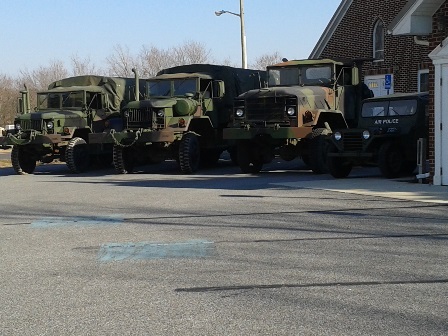

Trying one to see what size is best, here is our other toys

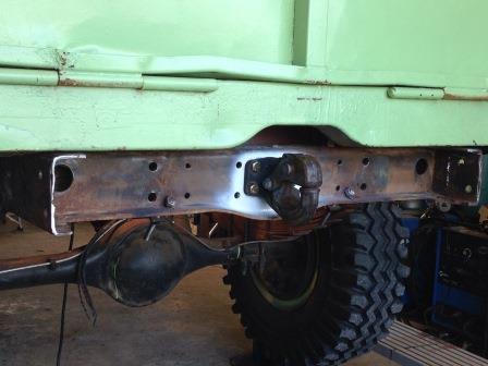

On the lift checking it out and looking at the massive reciever hitch someone installed. Welded to the frame, what a mess to cut off.

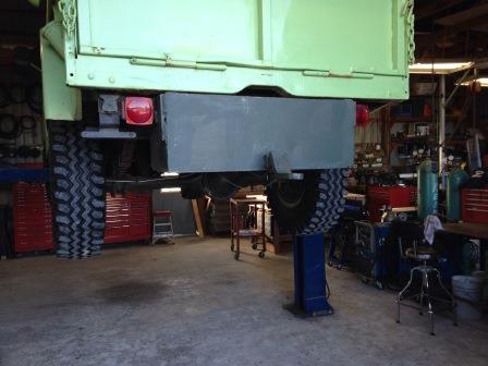

Gotta love the trailer lights with 24 volt bulbs in them :lol:

Old hitch all cut off and frame cleaned up. New pintle hook installed.

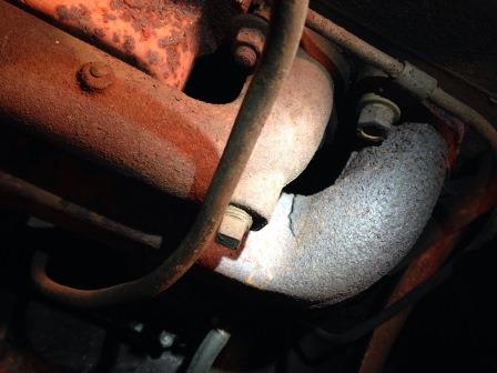

Found cracked exhaust manifold while removing all the rusted out exhaust. Will remove it and try to weld. Have had fair luck before on cast, so will try once anyway

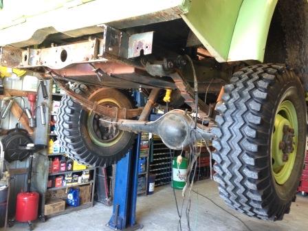

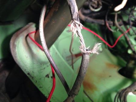

In process of striping out all wiring. Hoped to use over some but no way. This wire feeds the only breaker in the truck,

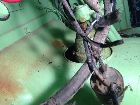

Ignition switch wiring. Someone used lots of silicone and tape. After last night we have every wire out of the truck.

The truck looks much better already, with that extra weight off the back and the trailer lights gone. Were you able to save the rear bumperettes?
You might want to consider getting the rest of the pintle hitch assembly that allows the hitch to rotate. If you ever get a trailer to haul behind the truck it will keep the trailer yoke from being twisted and bent.
Just a suggestion.

Forgot to add, that really, the best solution to the wiring issue is just to get new harnesses from Vintage Wiring of Maine. They are not cheap, but they are much cheaper than anything else when you consider your time, frustration, aggravation, and nickle and dime expense trying to rewire or patch together the wiring on these trucks.
Just another suggestion to consider. Especially since it is going to be your wife's truck. :wink:

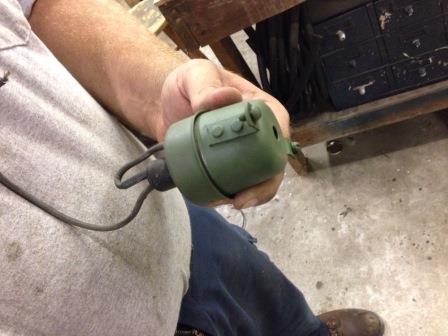

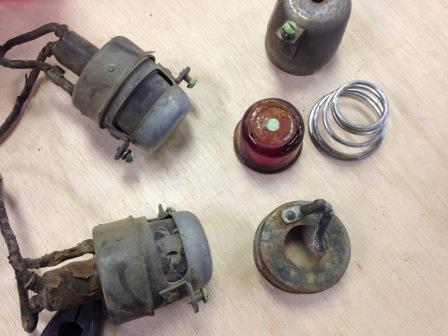

Dash lights were in terrible condition like the rest of the wiring. We had an idea to take apart and solder in new wire, clean up
My son did the dash lights, this is high beam indicator. All new wire soldered, new bulb and cleaned up. yeah i know painted 383 green but we dont have the right color yet. Beats buying new lights

Oh it weighed a ton. Used transmission jack to let it down. Didnt have any rear bumperettes, but I do have a used pair from Midwest that will work fine.
I agree on the pintle hook, and if i find the original I may change it. The swivel hitch is not really needed on this weight truck and small trailers on road. Swivel is great for off road and big trailers. This truck may never pull a trailer and if it does may just be our MEP-003a about it. I have 5 other M105s but are a little big for it. So maybe just generator to a show or something.

Your right on the wiring. As of last night every wire is out of truck. Not a piece could be saved. Definatley not worth patching up. I did look into some wiring harnesses and were in the $900 range.
Here is an area where it will not be original. We do have original packard wire, but will not use douglas connectors except on gauges. Everything will be switched over to packard connectors. The headlights and front turn signals were already switched to packard at some point. We will use the same wiring schematics but will be have a couple distrubution boxes added under the dash [not seen] that were not original. Just makes easier wiring and later trouble shooting. Ive spent 30+ years working on all kinds of trucks/equipment for a living. Wiring these up are a piece of cake compared to a modern truck that caught on fire :D
Always good to hear other ideas and thoughts. So anything anyone thinks off, just speak up.

Congratulations to your son for taking the photos. He did a great job rebuilding those dash lights. I hope you'll both enjoy rebuilding the M-37.
