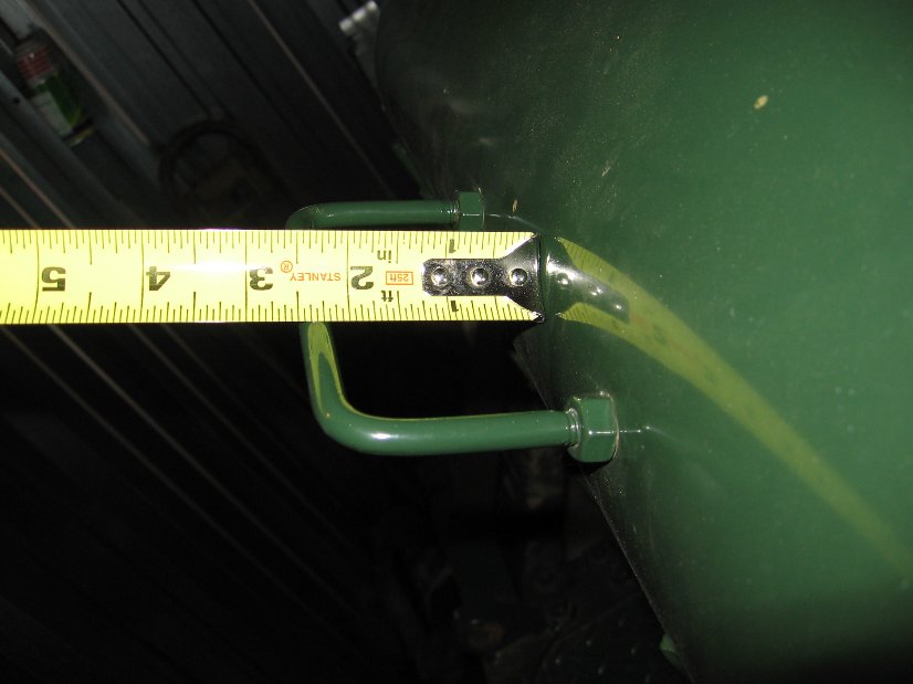

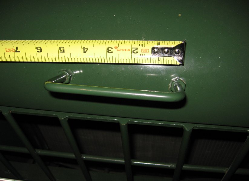

I believe these modifications were done with what was available. My truck, USAF, has a hood handle made from 1/4 diameter rod.

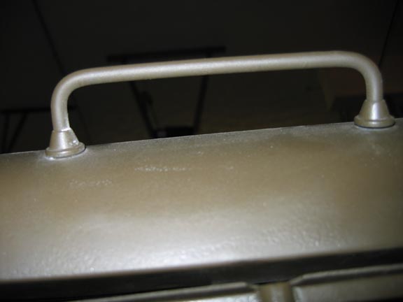

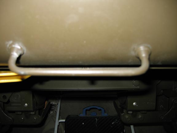

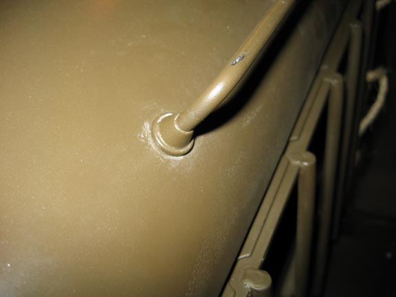

hi,i like the photos but where on earth would i get those cone shaped pieces at the base of the handle ?????,i hope this isn't more trouble than it's worth, thanks

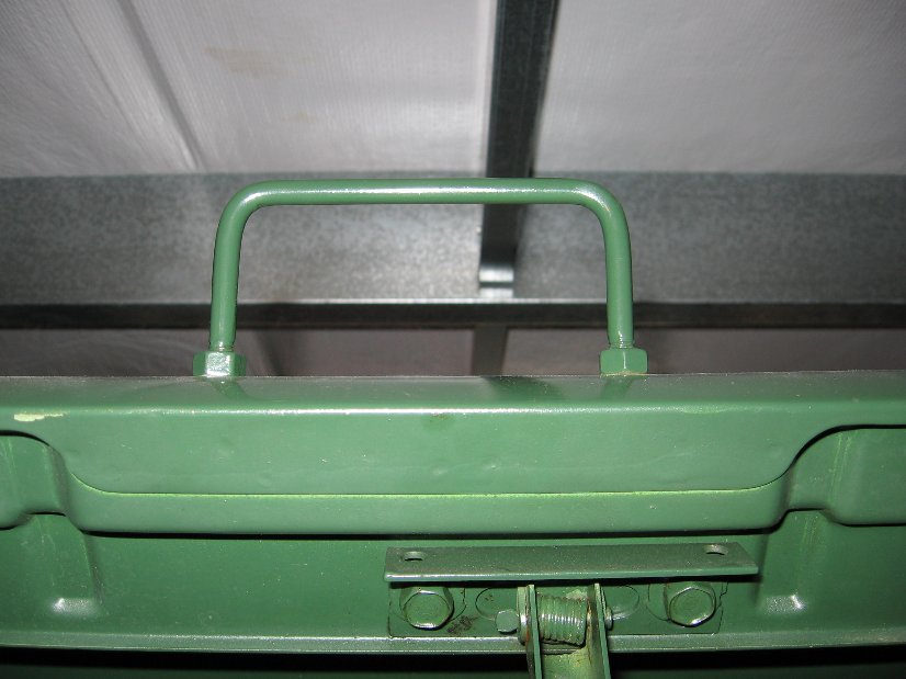

The hood handle on mine is simply a piece of rod bent like in the picture, but instead of the fancy little cone pieces, mine just has nuts on them, outside the hood and inside. I like the cones better!

I picked up a hood handle from Vintage Power Wagons when I was out at the Power Wagon Rally last year. We had the run of the yard. They had quite a few M37s with hood handles and I was surprised at the differences in the handles, even the height. The one I got (as did most) just had washers and nuts on the top of the hood.

The handle on mine is just 1/4 inch rod, threaded on the ends. Hex nuts top and bottom hold it in place.

Back to topic, the above pictures are what most all of the handles in the yard at VPW looked like. The ones with the neat ferrules must be an early version before they decided it was to much expense and just went with threaded rod.
