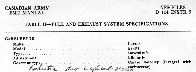

According to the EME manual, the carb should be an E9-D1 but I have the ETW1 on my M37CDN.
M37 Carb data.jpg (120.04 KiB) Viewed 861 times

Thanks for responding. Is your ETW1 stock, or did you have to jet it up for the larger engine?

rdwhite wrote:Thanks for responding. Is your ETW1 stock, or did you have to jet it up for the larger engine?
My carb is stock. I dont know enough about them to consider things like jetting them up.
