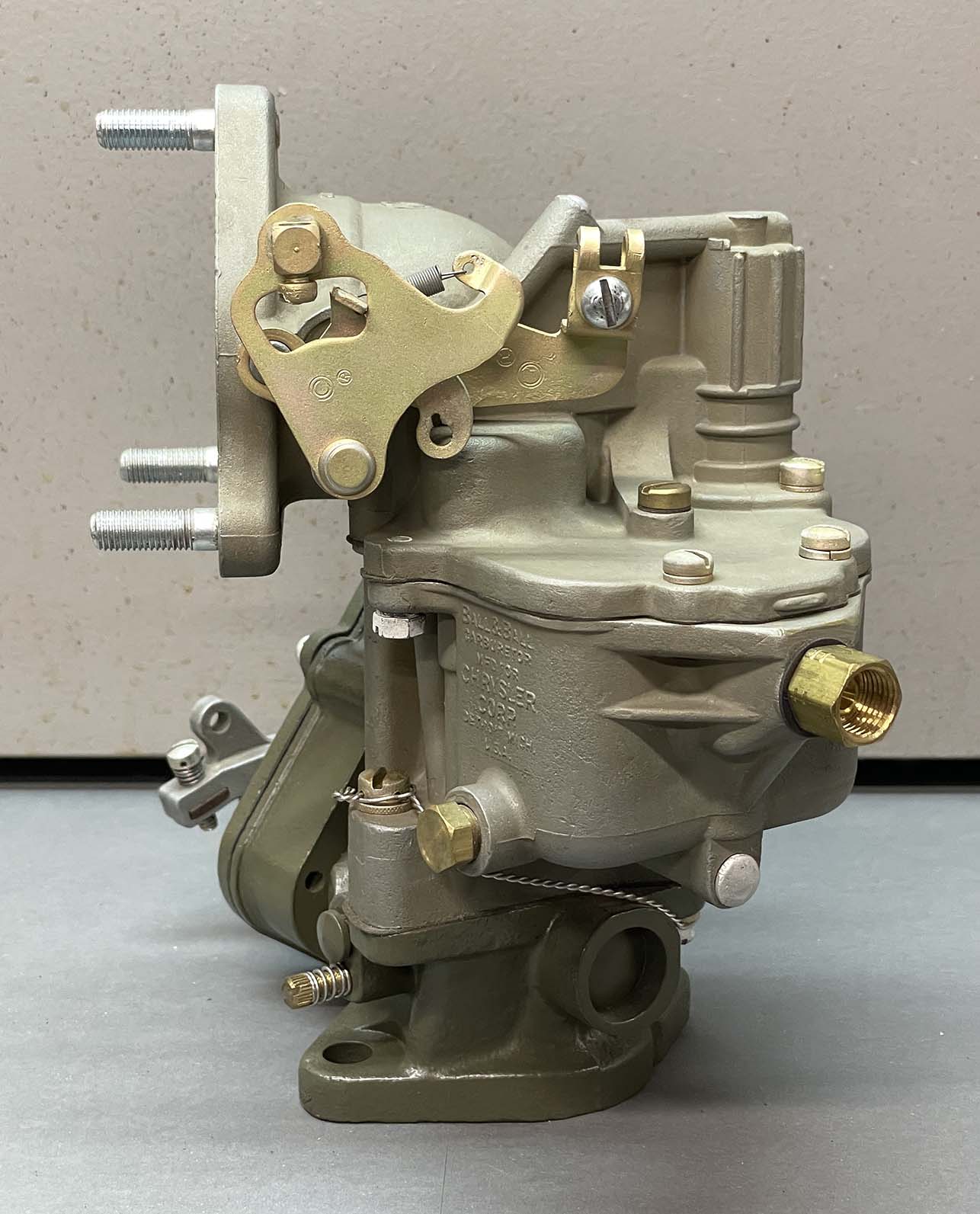

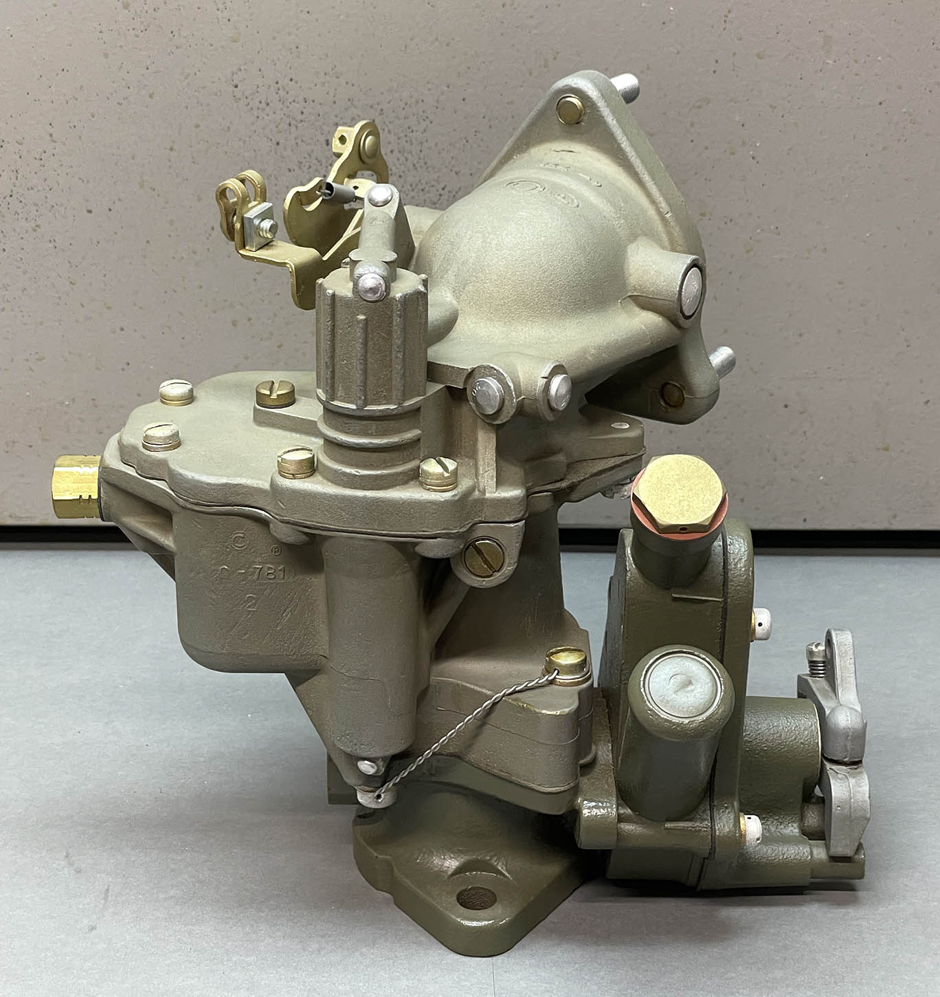

ETW1 carburetor. I rebuilt the carb completely, including re-plating the linkage parts, installing new passage plugs, refinishing the body with a dichromate conversion coating, overhauling the governor, installing safety lock wire, etc., etc.

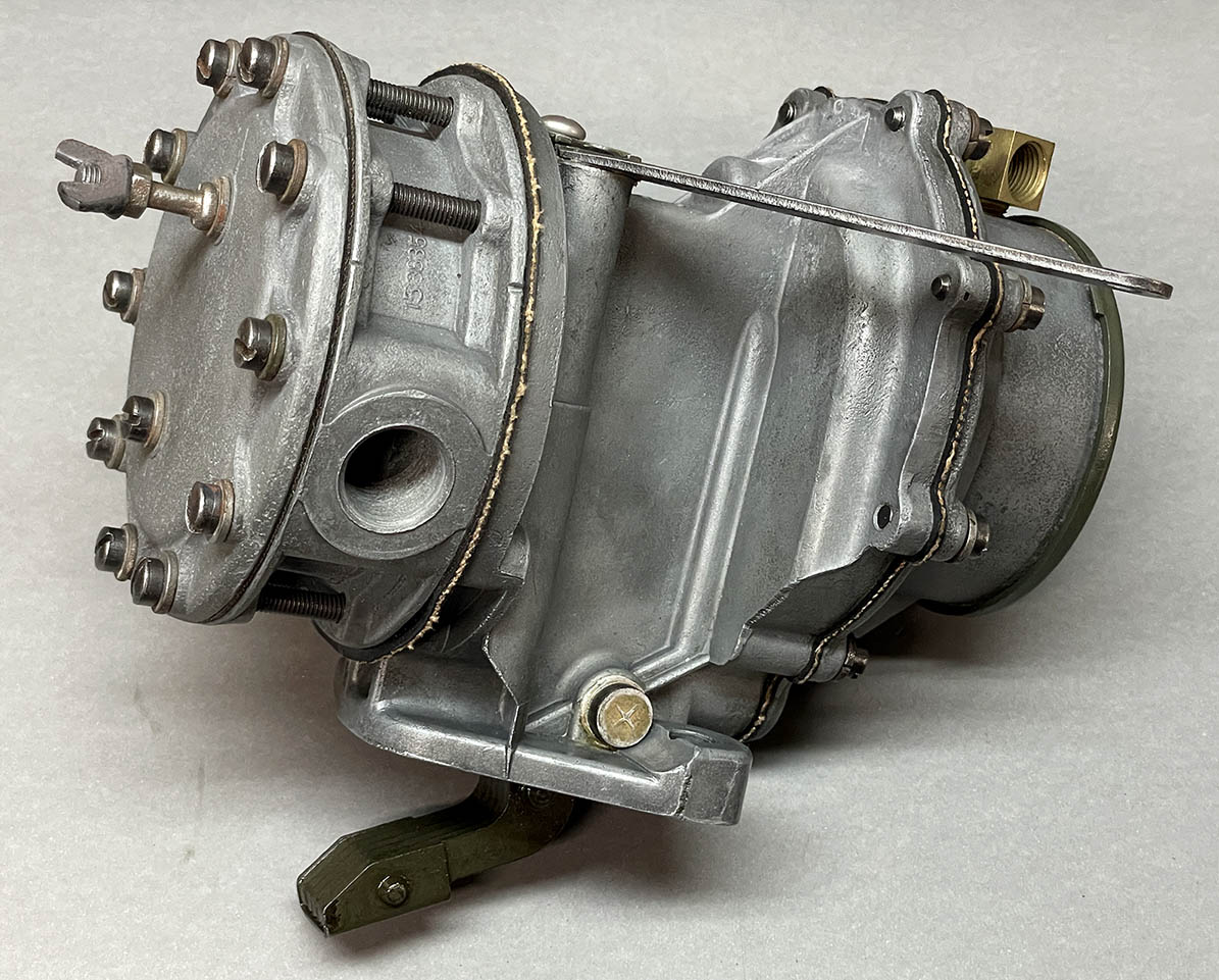

Here's the combination fuel/vacuum pump that I rebuilt:

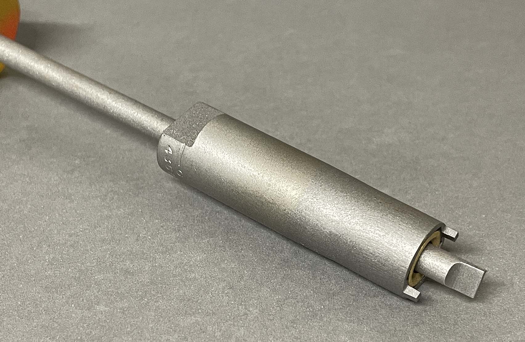

This is a specialized tool that I made for adjusting the carburetor governor. I made it from a screwdriver, a couple of bronze bushings, and an old socket. The bronze bushings keep the DIY hollow-ground screwdriver centered, and I filed the socket to make a couple of wrench facets and two pins/prongs. I had to grind down the lower portion of the socket to fit the opening, as I recall.

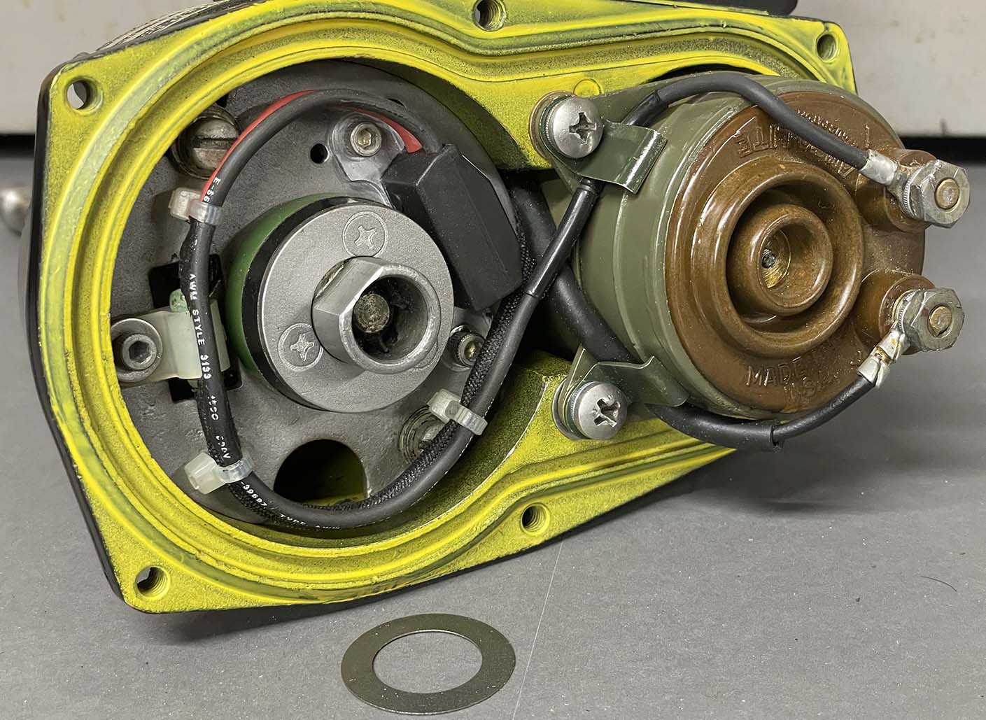

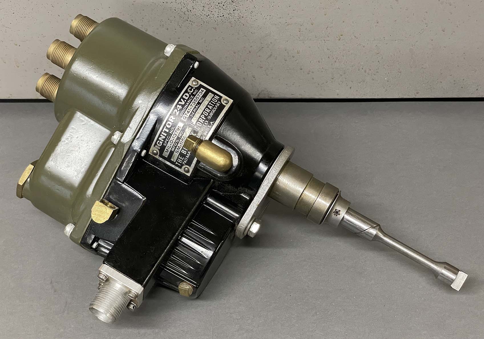

I totally rebuilt a couple of distributors. Here's one that I kept completely stock:
And here's another distributor that I set up for breakerless ignition with a Pertronix Ignitor. NOTE: I made this MANY years ago, before Pertronix was offering a 24V Ignitor to fit the M37 distributor. I used an Ignitor for another vehicle, and I custom-molded the inside of the magnet ring to match the distributor cam and installed a resistor, since it was a 12V unit that would be running on 24V. I still haven't tried it in a vehicle yet, but as I recall, it seemed to work fine on the bench.

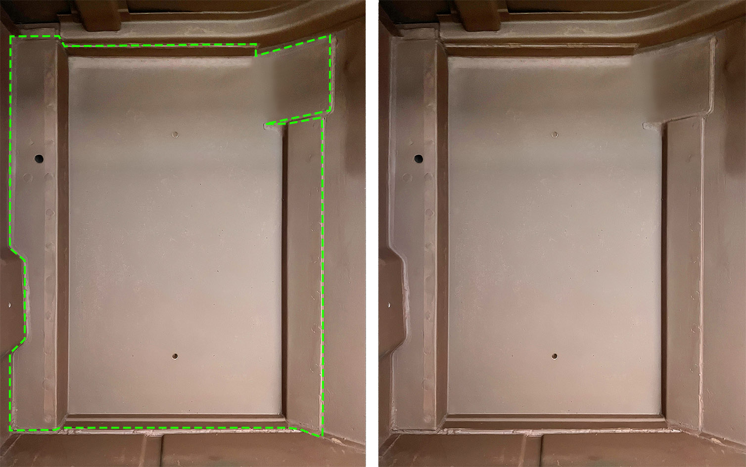

This is a repair that I did a while ago. The floor under an M37 battery box often rusts out, since it's out of sight and tends to collect dirt and water (i.e., mud). Sorry, no 'before' picture. I cut out that section of the floor, made a template out of thin, stiff cardboard, and used the template as a model for cutting and bending the steel replacement. The photo is looking straight down at the floor with the replacement piece installed. The green dashed line shows the extent of the new replacement piece. I welded it in place with at least 50 plug and stitch welds, sealed the seams with paintable urethane marine sealant, then applied a coat of primer. I was pleased that the metal replacement piece fit well with no further modification. Taking a bit of extra time to create an accurate template helped a great deal.

Hats off to that work. The carb looks neat. :D
