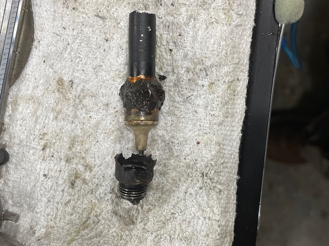

4) Removed 4 of 6 plugs fairly easy, #2 & #3 badly corroded.
5) Actually # 3 was completely rusted off leaving only the threads in the head.
6) #2 sheared off leaving just the base in the head😬
7) I ordered extractors from Amazon and removed the remnants of the two plugs from the head fairly easy.

Spark plug 🤪
