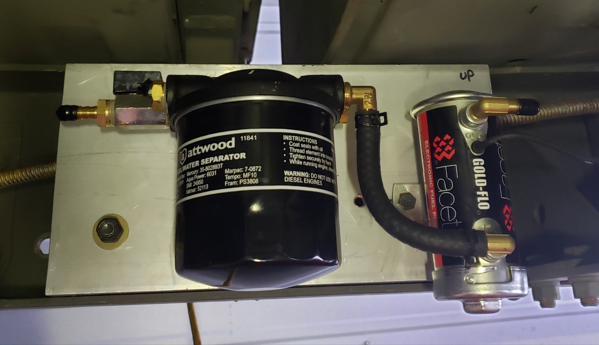

With the right electric fuel pump, there is no need for a separate pressure regulator. I used this Facet 24V Pump rated at 4-5 PSI mounted on the frame back near the fuel tank. I've got over 7000 miles on it with no problems so far.

John Mc wrote: Fri Mar 08, 2024 9:57 am With the right electric fuel pump, there is no need for a separate pressure regulator. I used this Facet 24V Pump rated at 4-5 PSI mounted on the frame back near the fuel tank.
Same for me. Although I still have the mechanical for the vacuum. I'll take it off in the future if I put on electric wipers.
