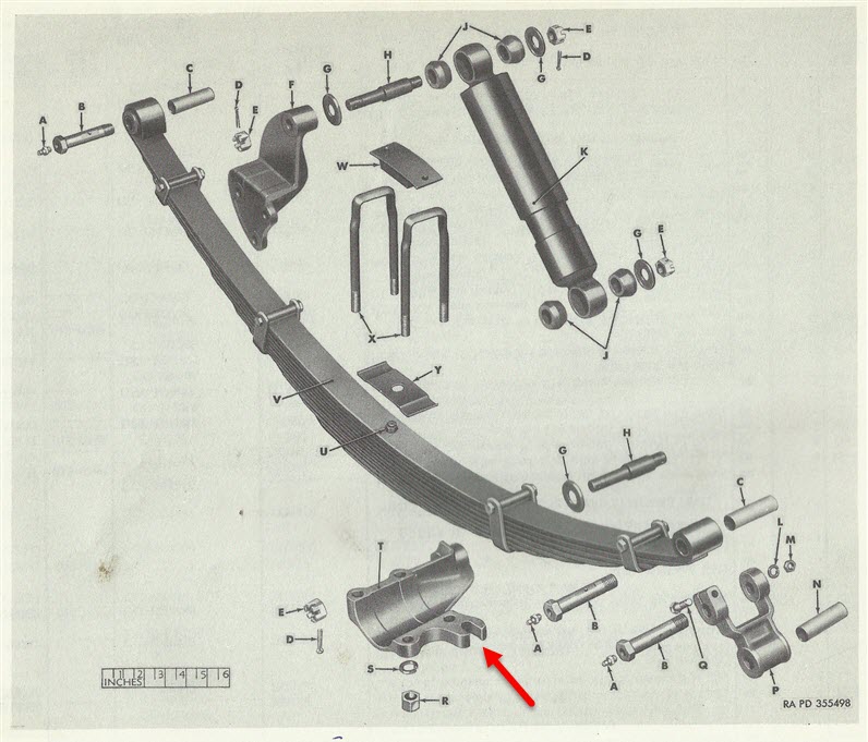

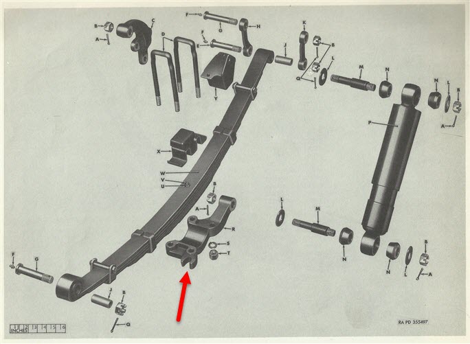

I've been recently active on the Steel Soldiers website, but I thought I'd dip my toe in the dedicated M37 waters. I've been working on my truck which I purchased in high school in 1972.
Does the hook-shaped attachment to the plate spring clip which joins the spring U bolts have any function? I can't seem to find any information in the manuals, though the graphics show the part clearly. I would attach photos, but the file size is too large. Thank you for your help.

Are you talking about those little things that almost looks like someone welded a small open-end wrench on to the thing? I've wondered what those are myself.

Those are for the jack. It has a spud that fits the casting in the spring plate.

just me wrote: Sun Oct 22, 2023 8:07 amThose are for the jack. It has a spud that fits the casting in the spring plate.
M37_ExpView_REAR SPRING AND SHOCK ABSORBER.jpg (95.18 KiB) Viewed 5552 times
M37_ExpView_FRONT SPRING AND SHOCK ABSORBER.jpg (52.22 KiB) Viewed 5552 times
I agree that those jacks are completely unavailable.
