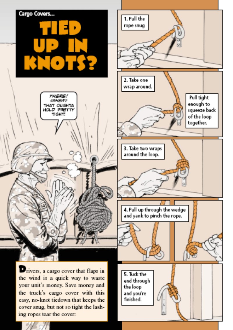

A little more secure method.

Great post, I've seen many different attempts to tie them off correctly with a multitude of knots involved, the diagram above is the way that I learned and still use to this day.
