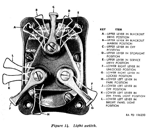

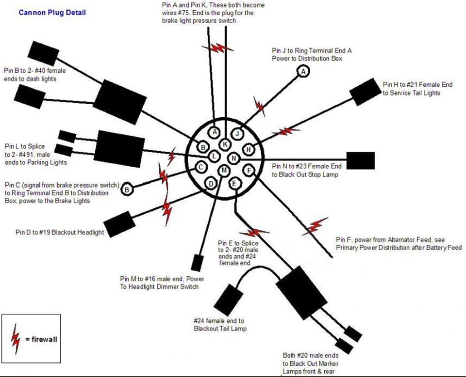

- Light switch pin outs
- Light switch pin outs.jpg (67.3 KiB) Viewed 6137 times
