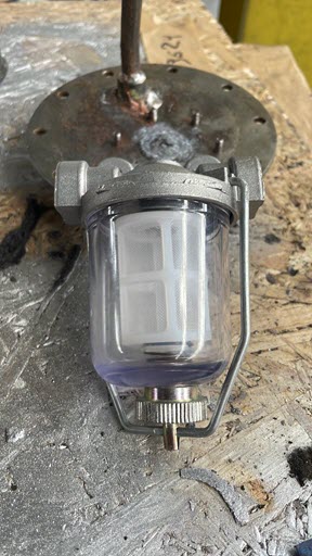

I will install a similar plastic filter right next to the pump in the engine bay. And I've procured this one (attached) for the rear, to be placed right out from the tank. It will be the first barrier helping me during the first weeks of running as I'm expecting a lot crap coming out from the tank + pickup.
Now, back to the plastic little filters I've never had problems managing them when disconnecting from rubber lines. I get your point on those edges but I think I got lucky so far.
- glass filter
- filter.jpg (43.18 KiB) Viewed 16118 times
