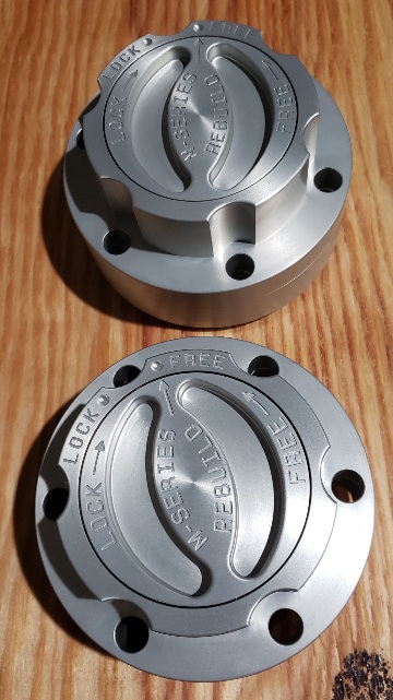

Currently waiting for 3 upgrade kits from Mseriesrebuild.com:
Locking hubs (silver)
Dual circuit pwr assist Master Cylinder
Power Steering

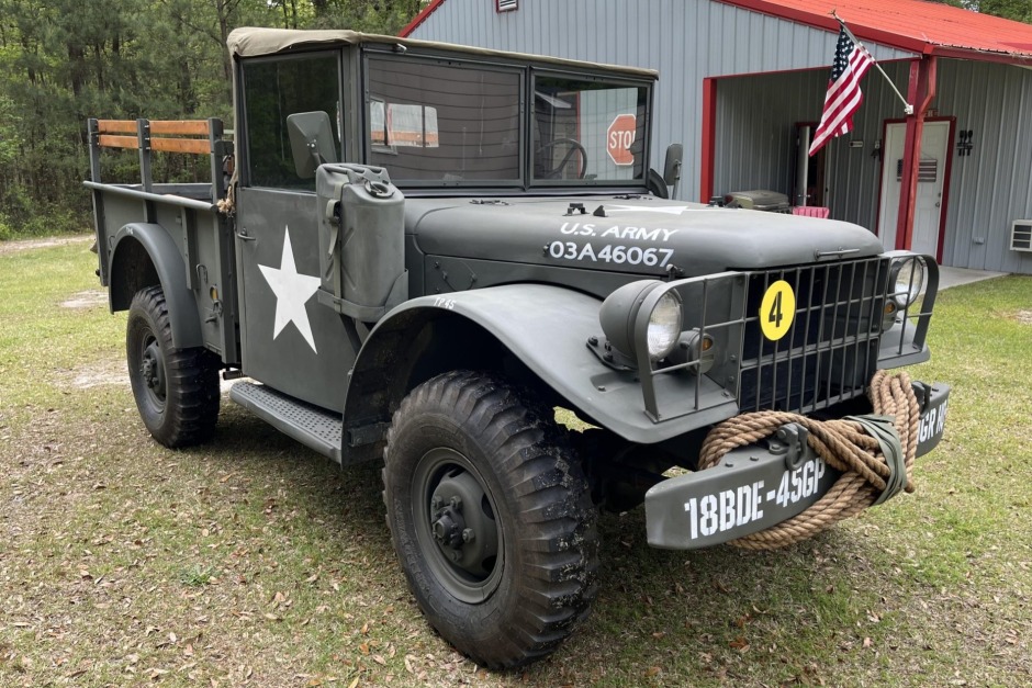

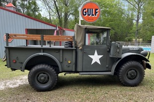

Before pictures
Follow me home...

Re: New to me '52 M37
Rdinatal,
Welcome to the community! Looks like a really nice truck. I look forward to hearing how you like it.

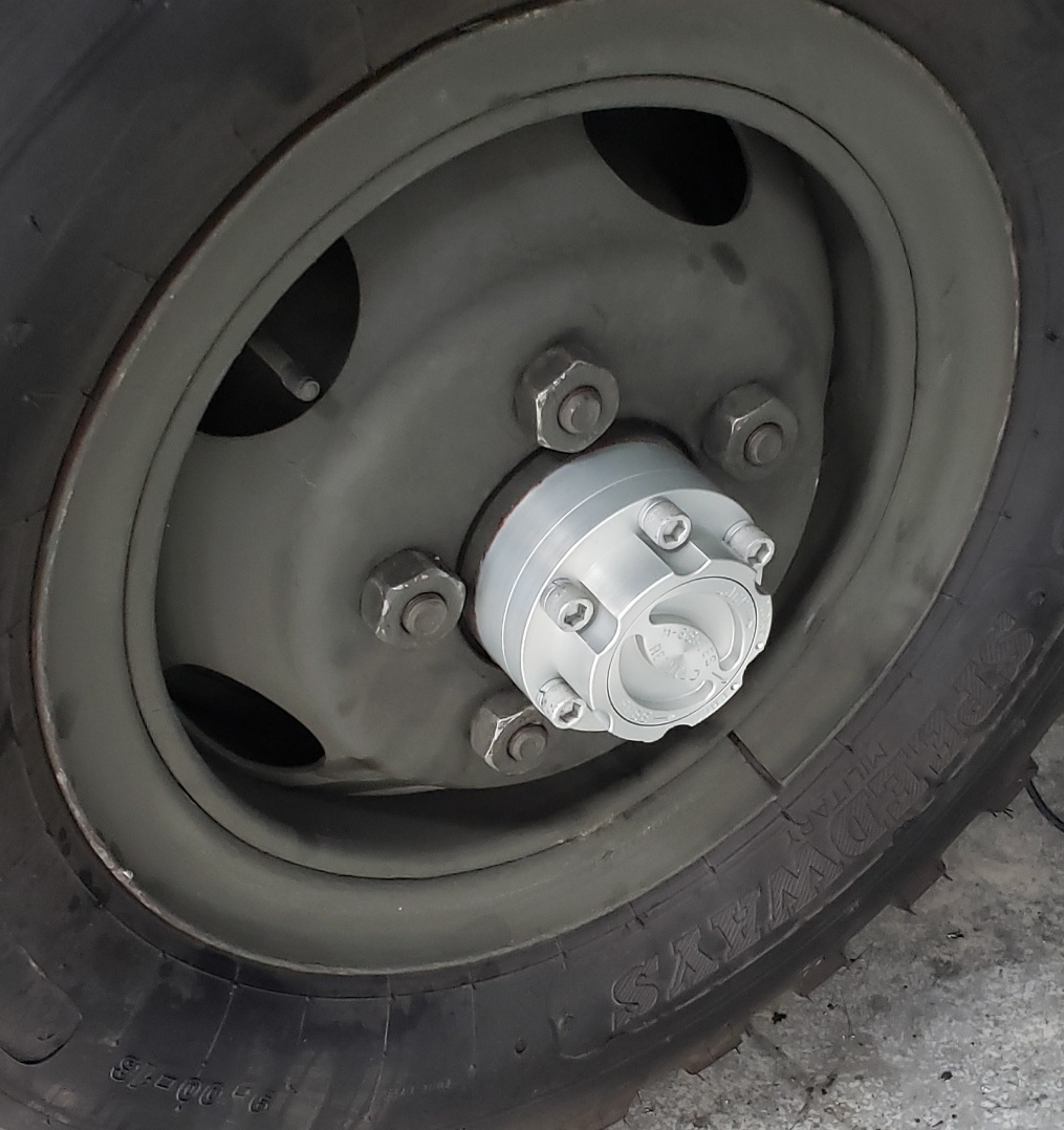

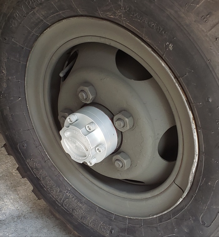

Putting on locking hubs from MSeriesrebuild. Started on the driver's side and have all but one stud out but that's fighting me. What can one do, or not to do, to back them out?
I've tried the two jammed nuts, working the lower one. They just spin. Even heating the stud up a little = spin.
Picked up one of those stud removers. The one with the knurled disk that wedges the stud against the tool body. Using that next.
greeno
Posts: 238
Post by greeno »
Before cutting up the threads with the stud remover, did you try red loctite on the outer nut?

greeno wrote: Wed May 24, 2023 5:37 am Before cutting up the threads with the stud remover, did you try red loctite on the outer nut?
Went the Loctite route. Worked great, the nuts didn't slip.
The stud broke. 😔 Will need to concentrate on that...
Anyway, went to the passenger side. All studs came out.

Post by Rdinatal »
Finally!! Got my exercise today along with my profanity quota. Drivers side hub done.

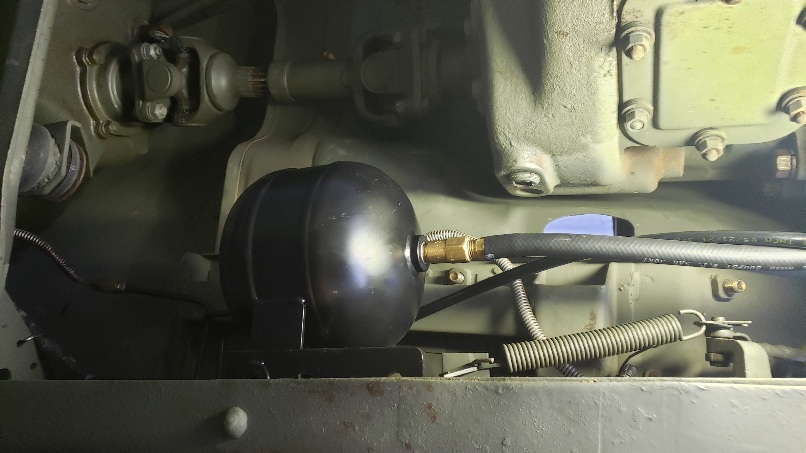

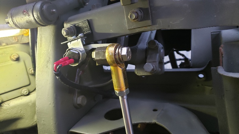

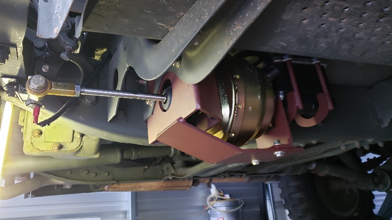

The power brake booster is installed with the remote reservoir and reserve vacuum can.
Changed to a mechanical brake light switch to reduce the complexity of the plumbing. It now has separate front/rear braking circuits.
Impressive!
Post by Argie1978 »
Well done.
