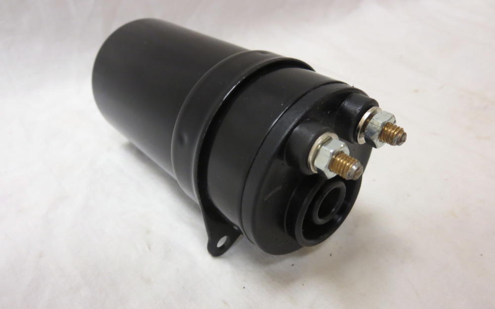

Have you looked at the 24V coils sold by Debella Jeep? They are made to mount inside the waterproof military distributor, but I wonder if they couldn;t just be mounted externally, if you have a civilian distributor?
Debella coil:
COIL 24 VOLT NEW 1 B.jpg (48.88 KiB) Viewed 8337 times
Re: 24 Volt Military Coil Modification
installed a DeBella coil in my military dizzy last summer, thus far all good. hal

NAM VET wrote: Tue May 09, 2023 6:33 am installed a DeBella coil in my military dizzy last summer, thus far all good. hal
I've got 5000+ miles on my Debella Jeeps coil with a Pertronix MV-161A electronic ignition. I have had absolutely no problems with this set up: easy starting, cold starts (including a few at 15˚F), hot starts, stop and go traffic in 90˚ weather, 300+ mile trip where I was driving 45-50 MPH the whole time (other than when a hil slowed me down), hauling 4000# load through hilly terrain (1000# in the bed, 3000# on the trailer). Very happy with it so far.
