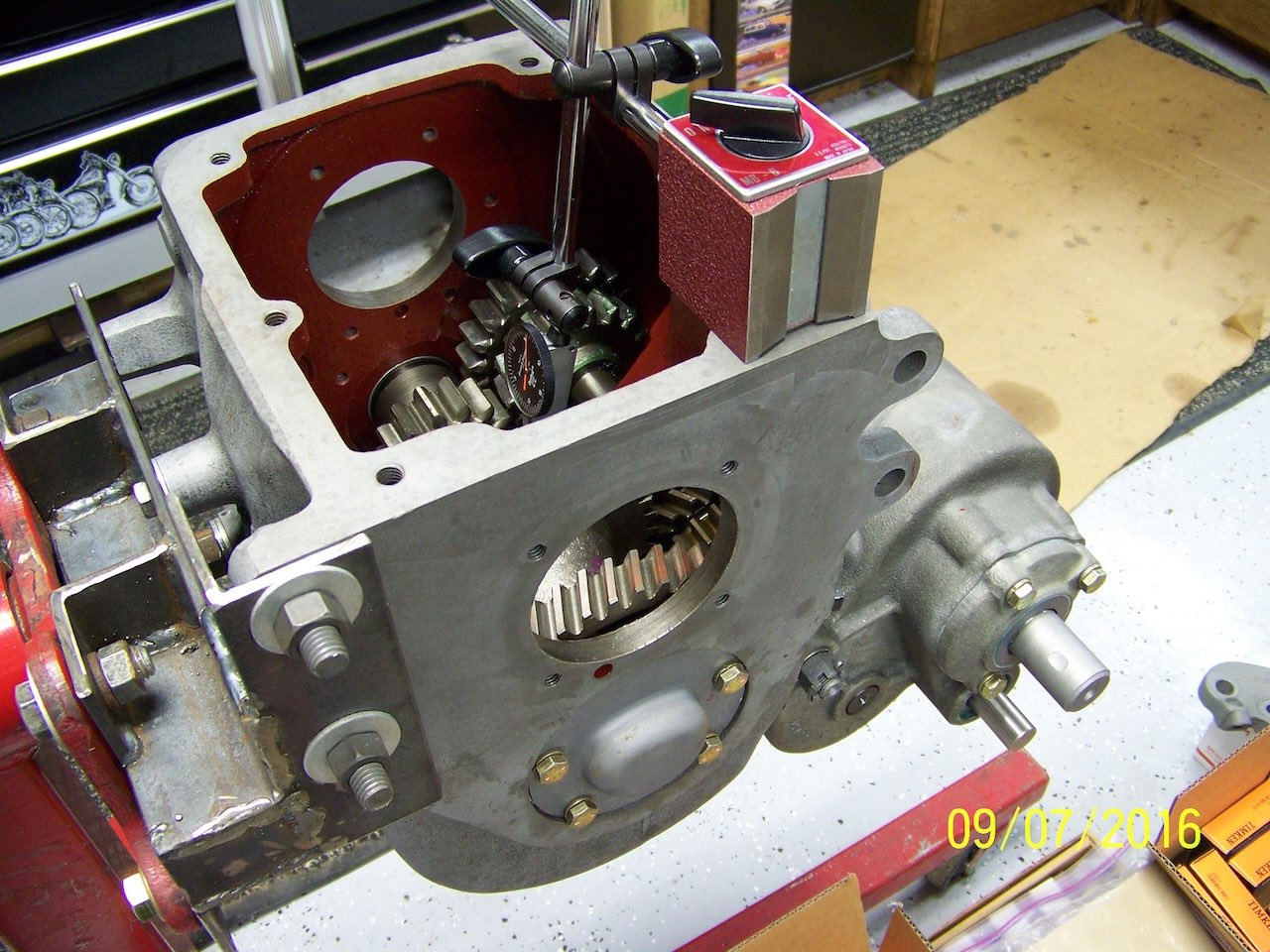

When checking backlash while installing the pto, where do you place
pointer on a dial indicator? I am assuming it will be on the tooth of the gear in the
transmission that engages the gear in the pto. This will be done on the opposite
Side of the transmission from the pto. Is this correct?i would think the pointer needs to be close to tangent withe the gear (90 degrees to the radius of the gear).
Thanks
Posts: 952
Re: PTO Transmission Backlash

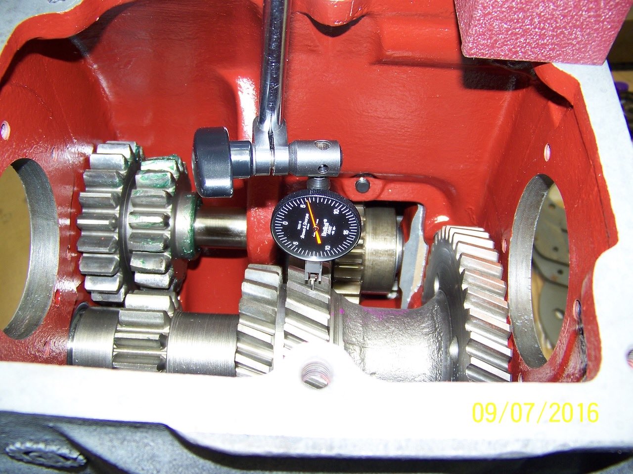

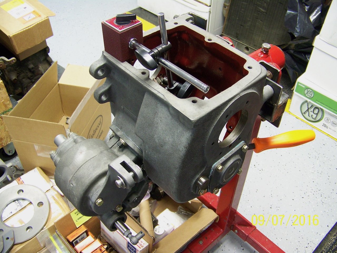

I used a test indicator - e.g. a Brown & Sharpe "BestTest", a Starrett "Last Word", or similar - since the movable arm was easier to get into the gear teeth than a dial indicator. The range of motion is very small, so the limits of a test indicator were not a problem.
Yes, the indicator should be on the gear that engages the PTO gear.
Accessing the gear through the unused PTO opening on the right side of the transmission would be easiest, but because of the way that my transmission was mounted in the engine stand, and since the mainshaft was not installed, I accessed it through the top opening.
