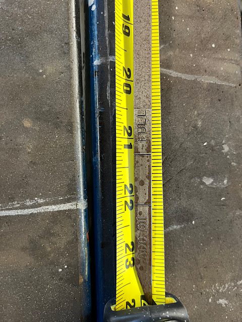

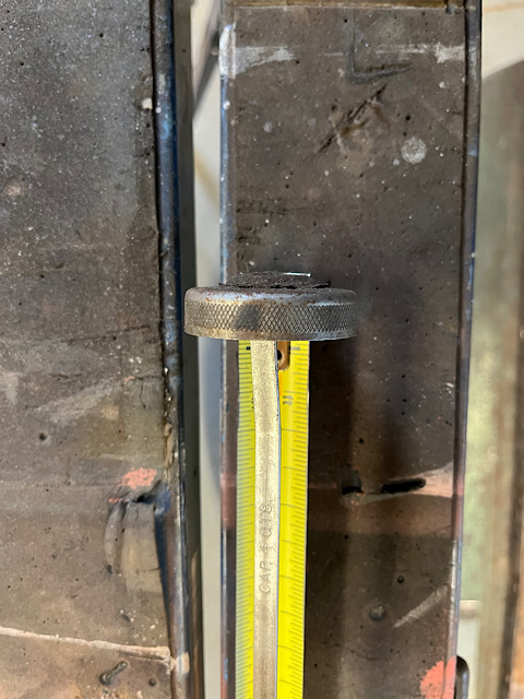

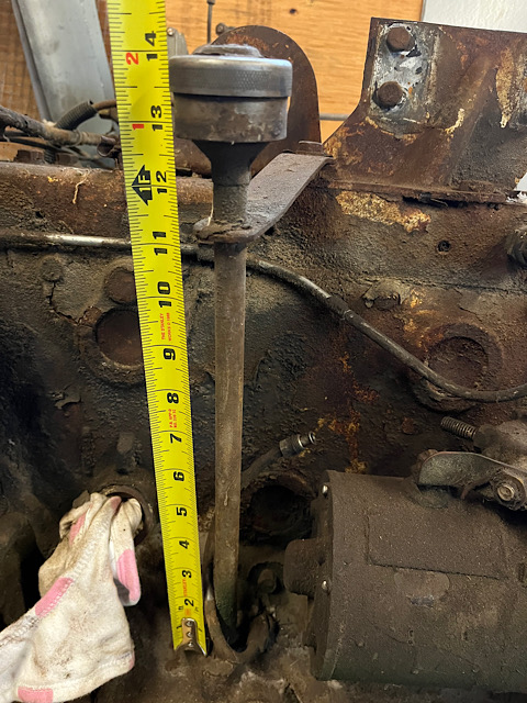

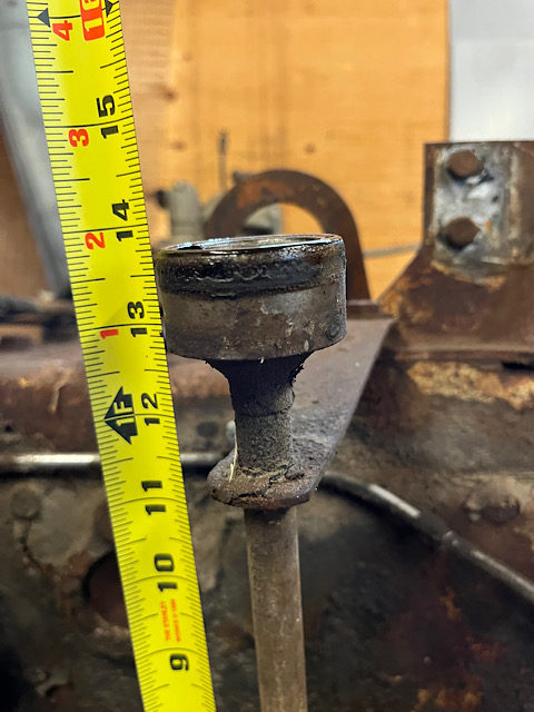

Ok let me know if this is enough

Posts: 436
Re: 251 oil dipstick length
Perfect, Rob. Thanks again
Post by RCrombie »
Yup it’s a 251, T249 model
Posts: 436
Mystery solved. My dipstick is the same as yours (or at least within 1/4" or so). My tube is one inch taller, causing my dipstick to read low.
