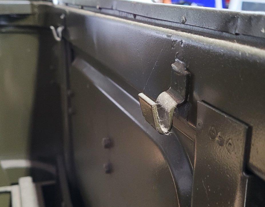

Does anyone have a picture of how the upper tabs for the passenger seat back look? Mine are tore off all the cabs I have available to look at. Any help is appreciated.

Thanks for the pic! Now I see why they are tore off both of my cabs.

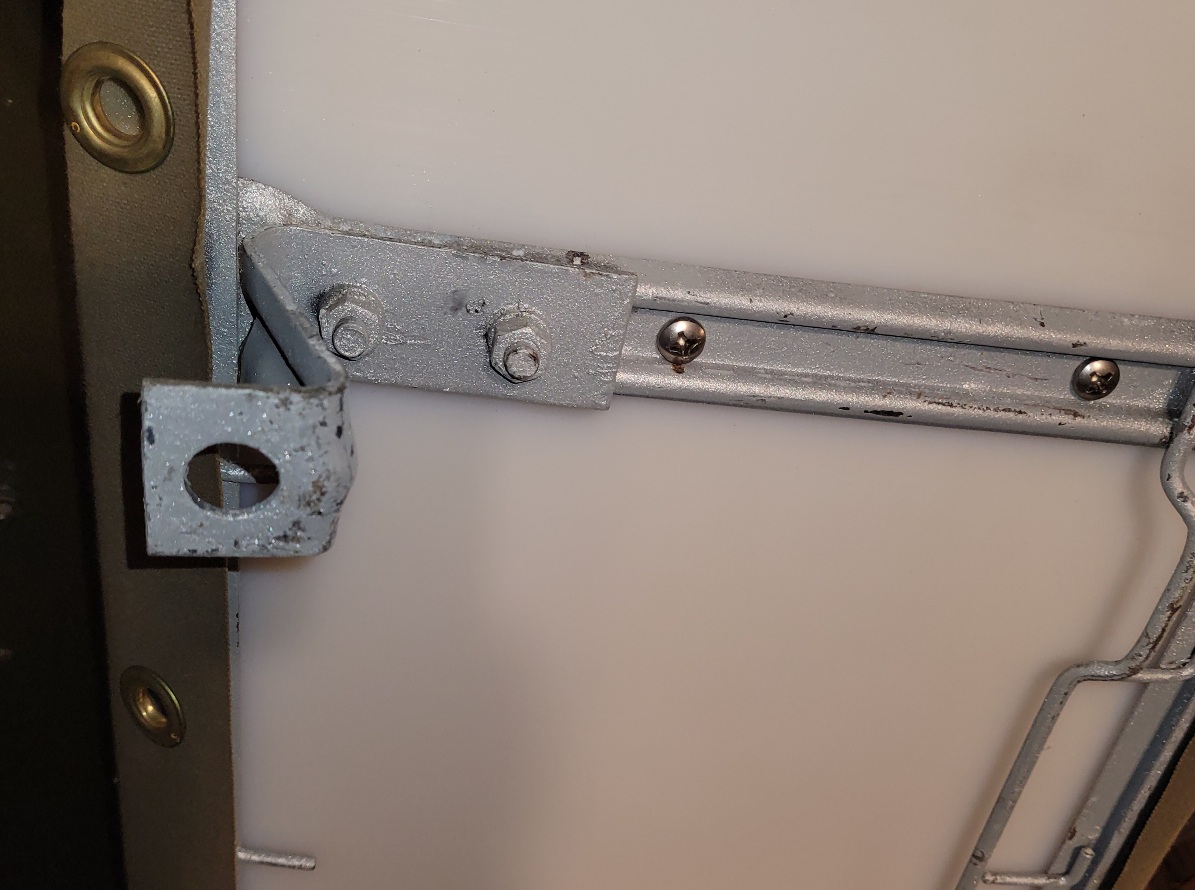

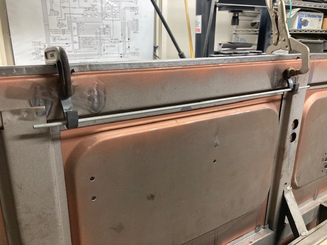

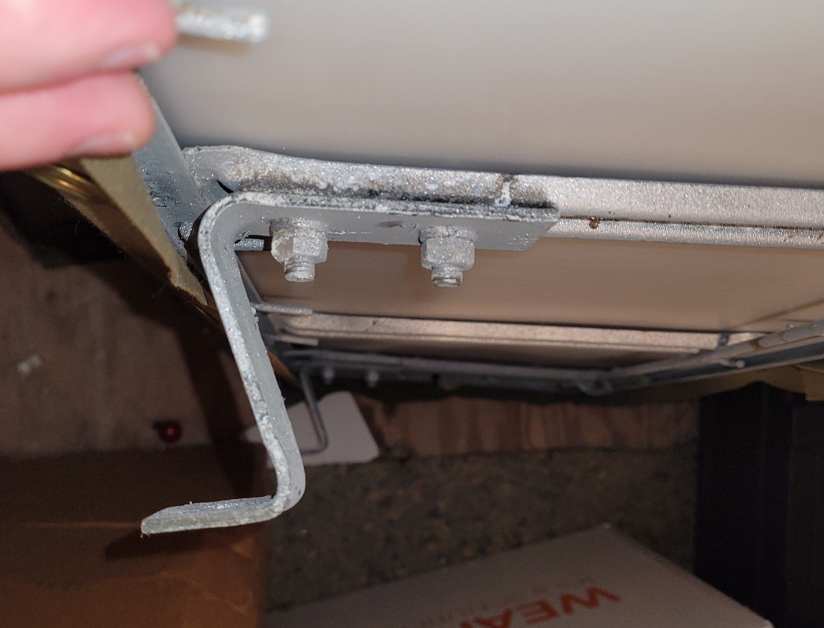

As mentioned before my cab did not have any mounting tabs for the seat. I am working on adding these tabs and still have a question that I cannot find addressed in any manuals. I see where the seat hangs from the tabs; is there anything that anchors the bottom side of the seat? Either to the back of the cab or something else? My seat frame has a couple studs welded on the back but there aren't any corresponding holes in the cab back. I do see a couple tapped holes in the rear framework that are close. Any additional guidance appreciated.

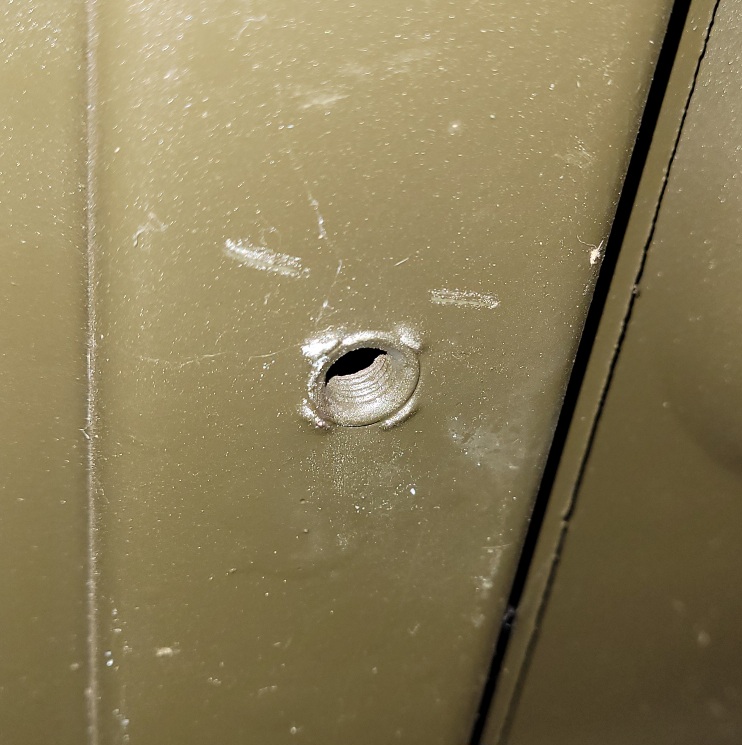

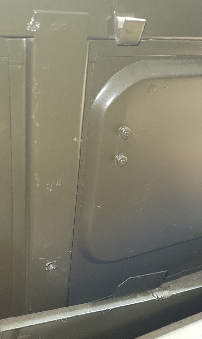

See pics. A bracket connects the seat back frame to the cab. The 2 lower threaded holes on the vertical strengthening channels are where it attaches.

Nice update Max!
Bubba tore off my mounts years ago, then hacked in some drop-tabs in the back braces.

Thanks for the pics; that helps a ton. I will either hunt some of those brackets down or make my own.
