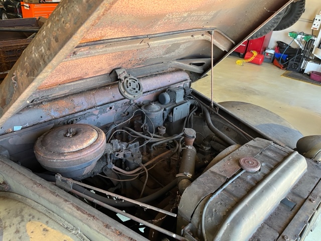

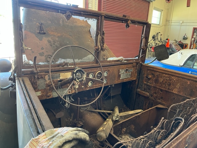

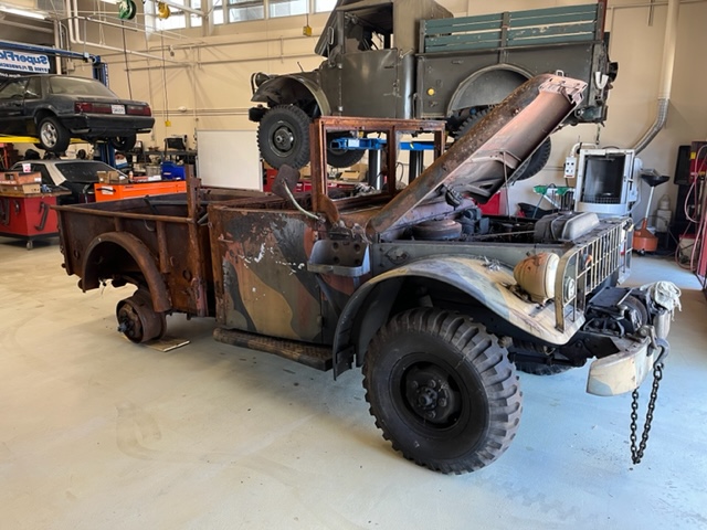

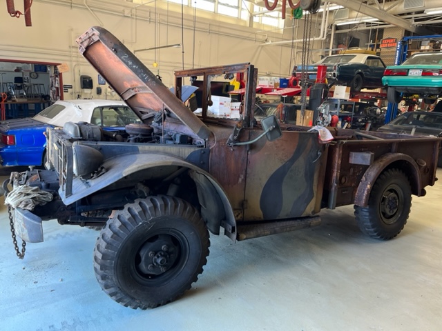

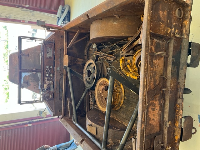

If you look at the photos you'll see that Peter's truck got a bit warm. It was stored in a steel barn during the Napa fires some years ago. Peter and his wife were lucky to have been able to evacuate, their neighbors didn't make it. Unlike the house, the barn didn't burn down, but became a large toaster. Peter lost a number of MV's and you can see the state of the M37. Prior to the fire it was a very nice truck. I have not had a chance to check it out carefully since dragging it down to the Shop, but I think the drivetrain ahead of the rear axle is in good shape. From what I can tell the fiberglass skylight over the truck melted and fell on the canvas lighting up the rear tires and the interior. The underbelly of the truck looks fine.

Likely the truck will be parted out, which pains me, but at least it didn't go to the scrap yard. I'm hoping to find some time to give it a good once over soon and see what's salvageable. Of course, I still have to get the other M37 back on the road!

I'd pressure test the radiator. It may have unsoldered itself in the fire.

That was my first thought. Fortunately the everything ahead of the firewall did not get very hot. I plan on testing it, but any damage is likely due to just sitting for years. Visually it looks great, to the point I wonder if was replaced and never driven. Fingers crossed since getting rad work done in CA has become quite a mission :roll: .

In addition to playing with the winch we removed the front clip and cut out the burnt up wiring. Removing some of that hardware was a bear! Once the front clip was off we started to check out the engine. The oil looked good, the dizzy still switched and the engine turned freely by hand. Then I decided we needed to have some fun. We grabbed a pair of batteries, some jumper cables, a small wire with some alligator clips, a can of brake clean and we were in business. After a few trial cranks we powered the ignition and tested to see if we were getting spark. We also checked to see if the wires were on in order (the kids took 'em off w/o thinking). Everything seemed to work, which is pretty impressive if you could see the engine compartment. It resembles the interior of a BBQ grill! Once we had everything on order and grabbed a fire extinguisher I fired some brake clean down the carburetor while one of the kids cranked the engine. It fired and ran!!!!!!! Good fun :) ! I'm not sure what went flying out the headpipe, but it looked like remnants of the mouse nest we found in the muffler, yikes!
Next we'll do some tests and see if we have a runner or a core. I'm hoping we have a runner!!!
