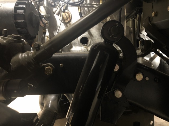

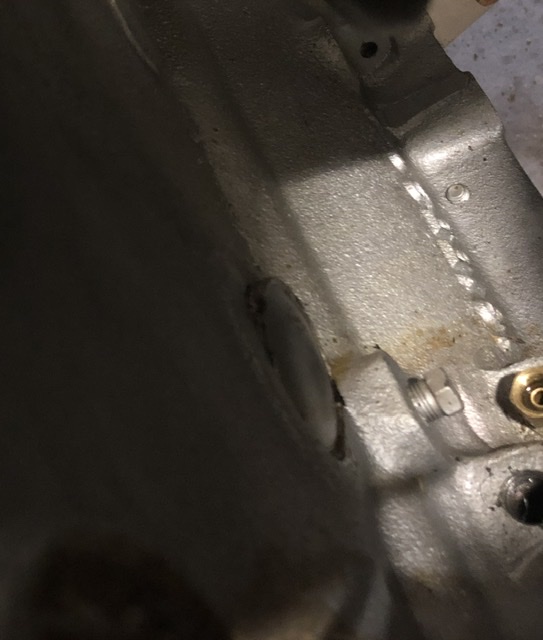

Got a mile from home today and noticed the truck was over heating. Once it was cool enough I added some water to the radiator…and it came pouring out the frost plug behind the starter! Grrrr….no parade for me Sunday!
This is a fresh rebuild. What could have happened and what should I note when reassembling? The head was hot, 300f on the IR gun.

Once you get to it, remove the leaker, apply sealer to the new cap, then seat it with the high side facing you, then stake it with a solid dimple in the middle with your ball peen hammer.
For those who aren't aware, those are actually the casting plugs when the block was poured, to allow the sand to be dumped once out of the forge. They may not do anything in a "freeze" situation.

Of course it would be one that’s tricky to reach! You might be in luck and be able to access it from inside the cab if you remove the panel on the firewall. I’m going to guess that either the plug was defective or wasn’t dimpled properly to hold it in place.
Often the problems are with the core plugs weeping, not popping right out.
At least they’re inexpensive and not difficult to replace, provided you can get at it and have enough room to set it in place.
Let us know how it goes! Maybe you’ll make the parade after all.

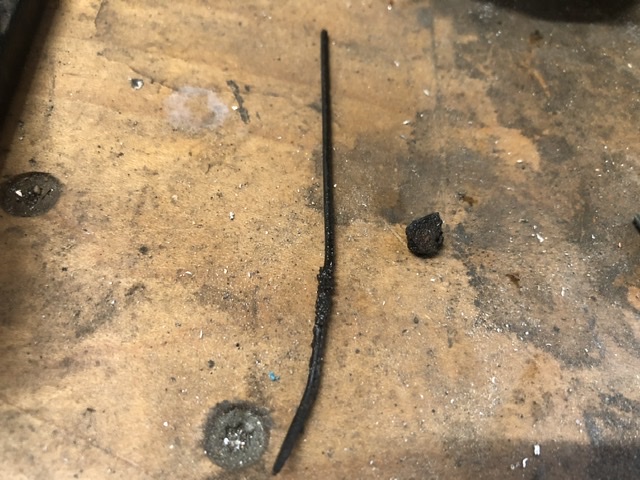

I can get at it. Fingers crossed I can dimple it tomorrow!
Look what I found behind the plug!!!
M37
YEAR: 1954
Re: Blown Frost Plug
WOW!
I fished a wire out of my head's heater plug upon removal once.

My frost plug replacement came out on my first test drive today. Argh!
M37
YEAR: 1954
You have to really set that plug with a mandrel of some kind (I use a socket & extension) if it is a cup type plug.
If it is a watch glass type, you have to push in in, then upset the dome by hammering the thing with a drift about half the diameter.
