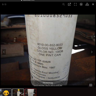

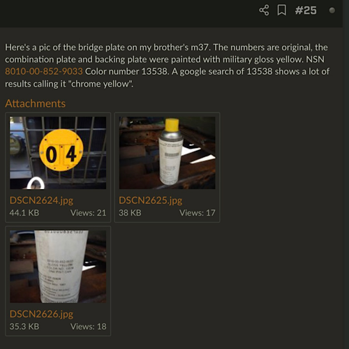

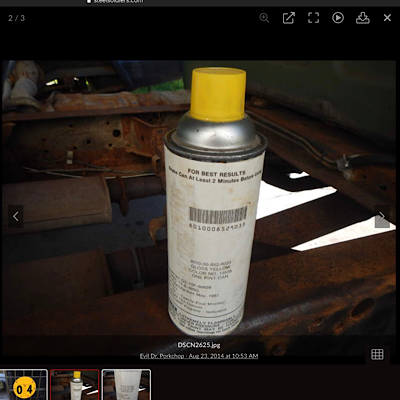

One more result of the Google search. This one came from another popular military forum. See attached pictures.

After researching TB 43-0147 C2 COLOR, MARKING AND CAMOUFLAGE PATTERNS USED ON MILITARY EQUIPMENT of December 1975, TM 43-0139
PAINTING INSTRUCTIONS FOR ARMY MATERIEL of 27 July 1988, and MIL-S-405626D(GL) SIGN KIT, VEHICLE CLASS of 31 March 1994 I believe the older Bridge Plate (applicable to the M37) should be painted as follows:
On vehicles painted in gloss colors, the markings will be:
Disk, retaining plate, steel bracket, & numeral plates:
Gloss Yellow Color Chip No. 13538 Yellow (gloss)
