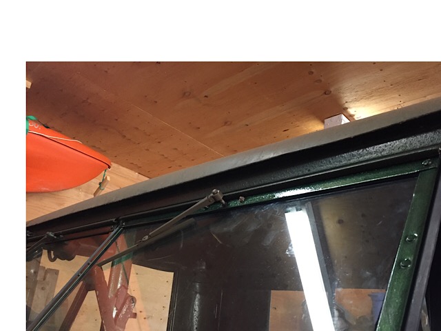

Here is how my hardtop is attached at the front. This is as it came from the military.
- 0E2D2807-8A1A-48FB-82B4-19040DA6F2EF.jpeg (95.18 KiB) Viewed 1653 times
- 36808478-F02E-4517-BAB6-1D71D688C8C5.jpeg (65.13 KiB) Viewed 1653 times

I can say that my hardtop must not be a factory original, as there is no way to use those tabs and locks to secure the front. Also the rear was probably attached with sheet metal screws. I am unwilling to drill holes in my truck so I will find another way to attach the rear of the top.

Those 'tabs' have to be removed to properly fit the arctic hardtop to the windshield frame.
The top front is then secured with several fine thread 3/8" cap screws from the inside.
Run a tap thru the captive nuts first, they have prolly never had any use before, and will really like to have the rust cleared out.
