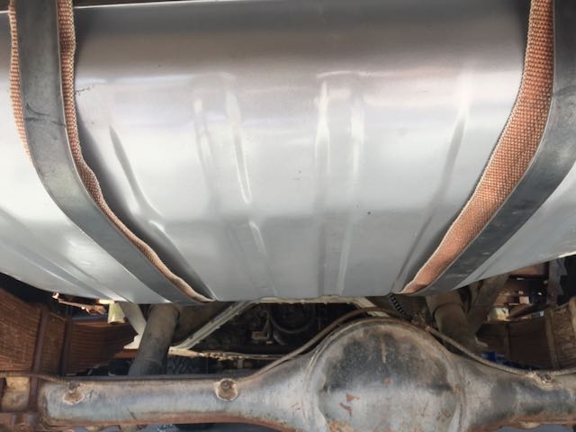

Here is a shot of a new S10 gas tank in the M37. The S10 is a 20 gallon tank, where the factory M37 was about 25 gallons. When I purchased my M37, it had a tiny 12 gallon tank in the truck. That was rusty and had to go. Did not stomach a $700 bill for a newish M37 tank. The S10 was $100, delivered.Cal_Gary wrote:Welcome Brett and thanks for saving another M37!

Re: Guns & Gas Tanks
What a clean install, looks like it belongs there.
Lookin' great!

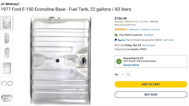

There is a Ford Econoline van tank that fits even better and is 23 or 24 gallons. You will need to google it. It is also a sub $100 item.
Interesting. I'm not finding an Econoline tank that is 23 or 24 gallons, however. (Though I'll admit searching for car parts is not something I'm good at.)just me wrote:There is a Ford Econoline van tank that fits even better and is 23 or 24 gallons. You will need to google it. It is also a sub $100 item.

This is what I found for the Ford Econoline gas tank.

OK. I found the link based on the image posted by outpostM37.
https://www.carparts.com/details/Ford/E ... 70143.html
Is that the one known to fit?
The dimensions and good pic here. E250 BEHIND the axle tank.
https://www.rockauto.com/en/catalog/for ... +tank,6268
If you can get the physical measurements for that ford tank then it might work. You would have to modify your pick-up tube and your sending unit for it to work with the M37. If you have the original tank still then look into either refurbing it your self with something like POR-15s tank renu or a company like Gas Tank Renu to see about getting it fixed up. There are other pour in and slosh around and let dry products just I found the POR-15 one this afternoon so it's fresh in my mind...
