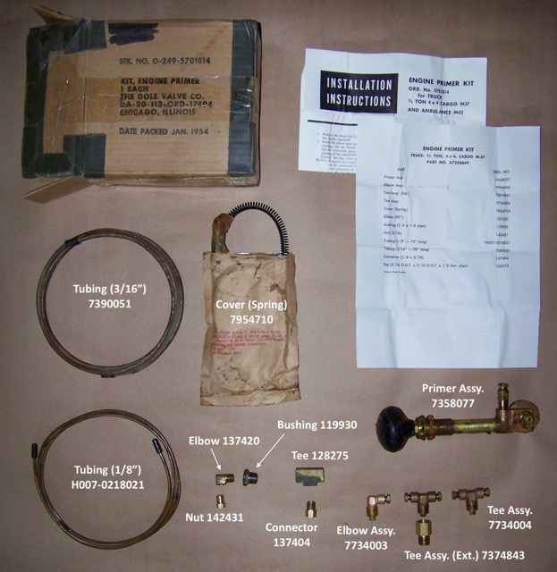

Here's an old thread with a series of good detail photos by Storm Stevenson (who sadly passed away in April 2019, his forum name was "52 M-42") showing the primer installation on his M37.slk wrote:Does anyone have any pictures of the entire pump and lines to where they go. Where it is mounted on the dash, and how it connects to the carb or intake??

Here's a photo I posted years ago (seems to have disappeared when the image hosting changed) that shows the kit contents with individual part numbers.
