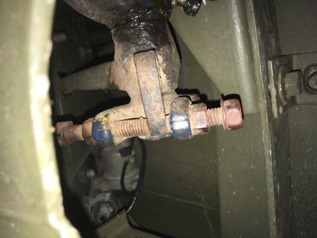

Cliff
Posts: 69
Re: M-37 trans gears grind
Post by Cliff »
I took a picture of the adjustment point on my truck and the first thing I notice is the difference between how my truck is currently adjusted vs how your truck is adjusted. What I mean is the two bolts (upper and lower) on your truck are adjusted evenly whereas as you can see by my picture of my truck the adjustment is way to the lower side. I don’t know if that is relevant but it seems to me it should be.[img][img][/img][/img]
per my pic, to increase your pedal travel, to completely disengage the clutch disc, loosen the lock nuts, screw the bottom bolt in a few threads, after loosening and backing the upper bolt out a few threads,, then see if that fixes your disengagement problem, if not turn in a few threads more, and once it works ok, tighten the two lock nuts. Try to have no "play" or looseness in the bolts/nuts/pedal "thingy." I may have this adjustment scheme completely backwards, but this how you moved the pedal and where it disengages the clutch disk. Put some grease or oil there, too. Hal
turning your pic to compare to mine, it seems to me that your lower bolt is not screwed in far enough, , and the upper bolt is way too long. Shorten the upper bolt, screw the lower bolt in more. See if that helps. That should move your disengagement up oof the floor. Hal
oh, wire brush those threads first, then put some Kroil or other thread loosening oil on the threads. Hal

Cliff
Posts: 69
Post by Cliff »
I did as you suggested and it did not work for me. It moved the free play from 3 inches to 5 1/2 inches. That means the clutch was releasing less than before so I adjusted the upper and lower bolts back to the same position As when I started. I also moved the truck in and out of the garage and it shifted just fine after I reset things back to the position In my picture. But keep in mind I have not driven it enough for everything to warm up to see if it still grinds in 1st and 2nd after sitting at a stop light in neutral as it was doing before. My guess is it will still grind. I will drive it tomorrow to see how it does. I will let you know. Cliff
Cliff
Posts: 69
Post by Cliff »
I forgot to mention I would have adjusted the other direction but as can be seen by my photo there is virtually no space to go the other way. Is there another place in the linkage to make adjustments or am I looking at a clutch replacement?
