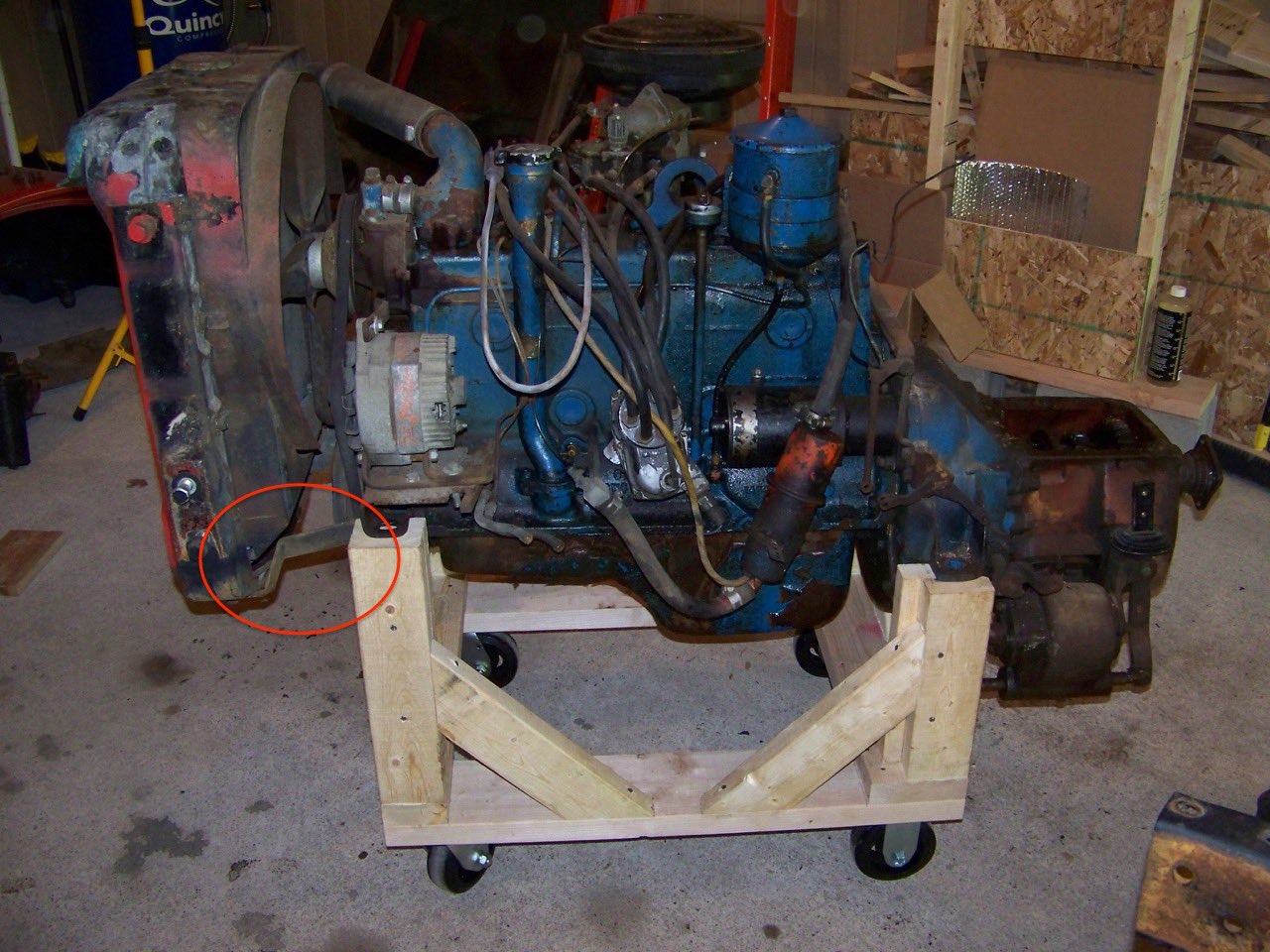

In Tm9-8030. page 175... the pic shows a bracket on the bottom of the radiator going to the front engine support....Is that an actual part? I don't seem to have those....

See Fig. 05-1 in the service parts manual ORD 9 SNL G-741. The brackets are "BB" and "RR".
See left side bracket circled in red below. There's a matching bracket on the other side. These brackets allow the complete power assembly (engine, transmission, and radiator) to be removed and installed as a unit.
