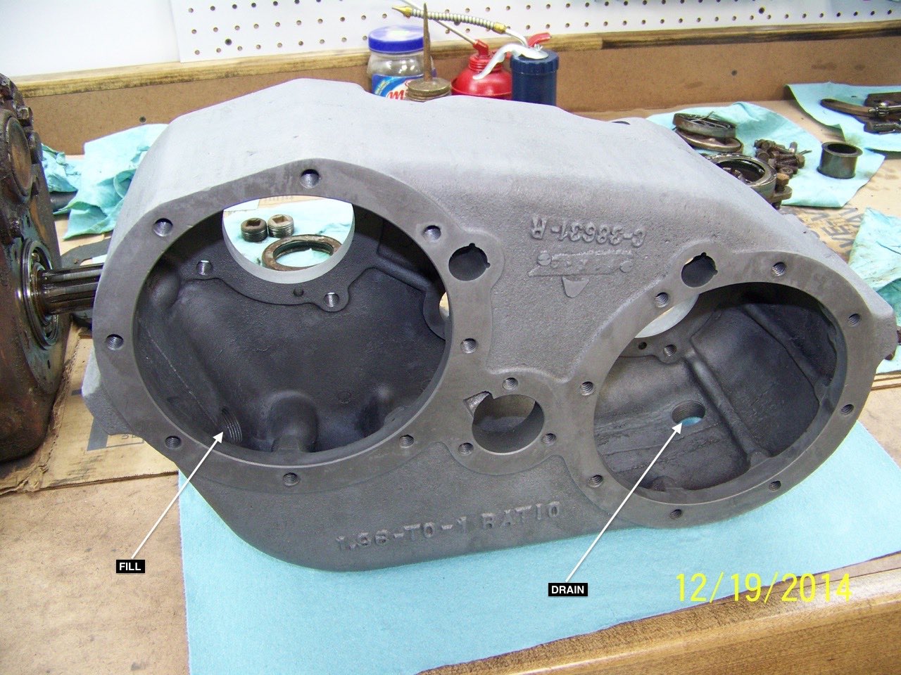

Where is the transfer case fill plug....I can see the drain plug on the bottom and another on the side by the bottom...So if TM says fill with 5 pints where is that fill point or do you need a pump to attach to the side plug? None of the pics show a location.....

Lubrication Order LO 9-2320-212-12 states to fill to "plug level".
