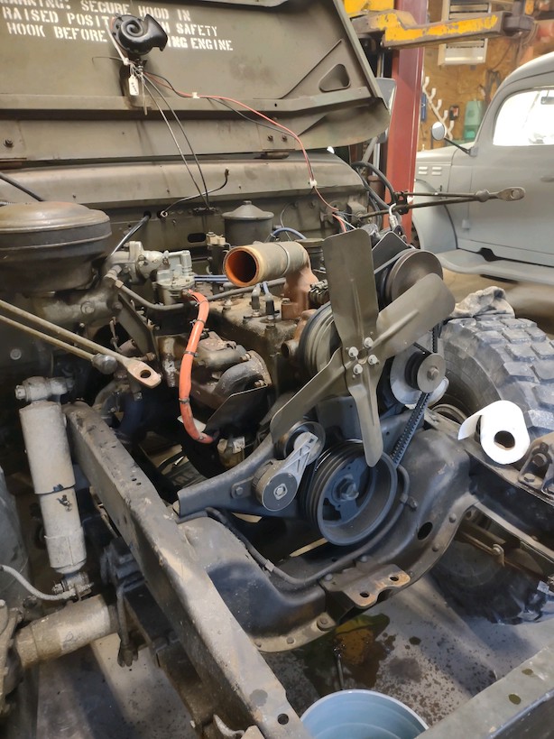

Cowling removed:
cowling removed sm.jpg (135.16 KiB) Viewed 17445 times
Ready to pull the engine and transmission (Don't ask me what the roll of TP is for)
Ready to pull 230 sm.jpg (145.31 KiB) Viewed 17445 times

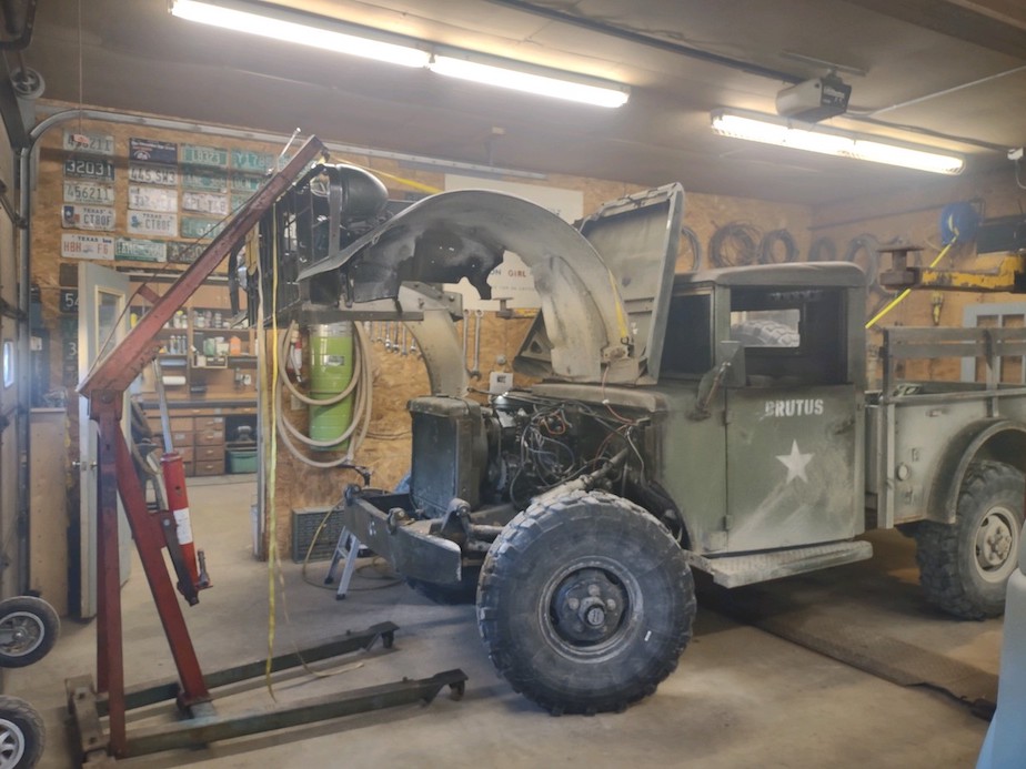

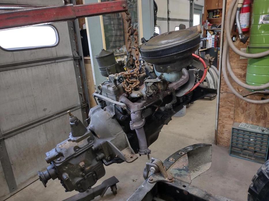

Engine and Transmission pulled:
Engine+trans out copy.jpg (98.65 KiB) Viewed 17434 times

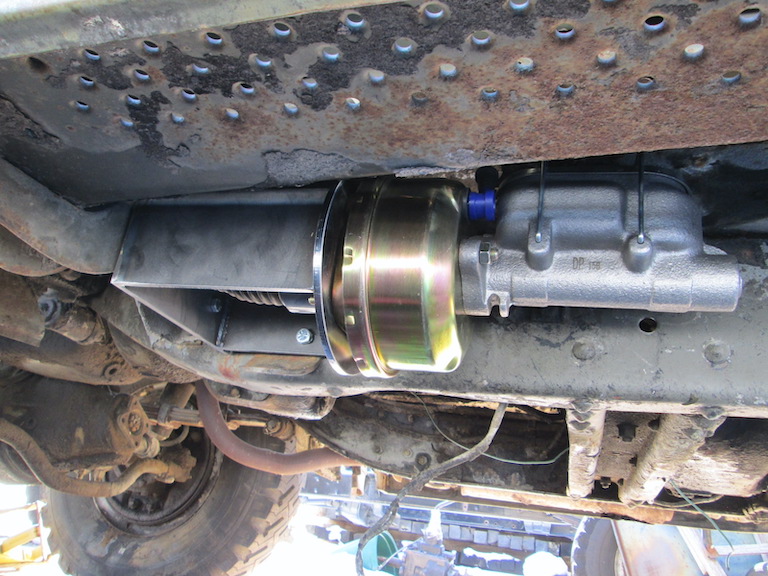

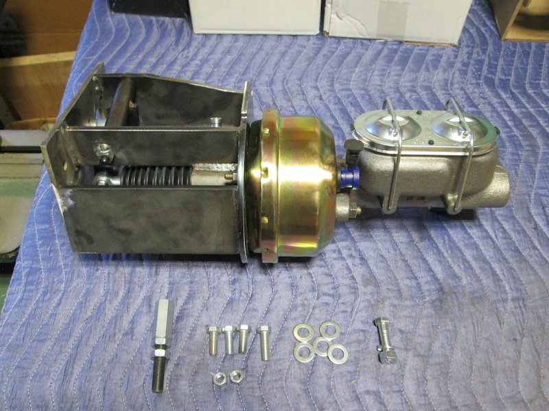

Not my truck, but these are pictures of Greg Coffin's brake boost system that will be going in to Brutus.
M37 Brake Bracket (1).jpg (179.3 KiB) Viewed 17386 times
M37 Brake Bracket (3).jpg (177.13 KiB) Viewed 17386 times
Re: M37 "Brutus"
That certainly looks well-made John, thanks for sharing!

Hard to tell how well-protected it is in that spot. It is tucked up beside the frame, which should help. I do a fair amount of driving in the woods: mostly on trails, but some of them have waterbars for erosion control, which are like driving over a hump, followed immediately by driving into a ditch. I scraped my Tacoma's underside a could of times (but it does not have near the ground clearance of Brutus). We may end up adding a small skid plate, if it looks as though it could use it.
Re: M37 "Brutus"
Yeah that might not be a bad idea since it's so much bigger than the stock MC.

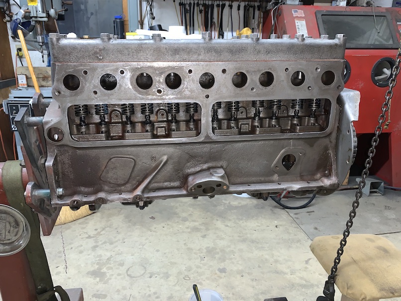

251 engine freshly rebuilt by Ken Holmes in Worcester, MA:
251 rebuilt.jpg (220.13 KiB) Viewed 17309 times
251 rebuilt 2.jpg (225.96 KiB) Viewed 17309 times

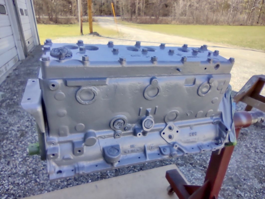

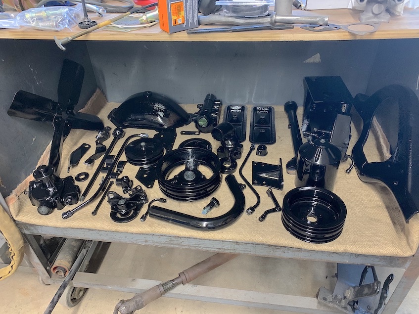

Tim Holloway has been sandblasting painting some of the parts:
parts painted.jpg (236.84 KiB) Viewed 17308 times
And painted the engine and some associated parts today:
Engine painted.jpg (236.85 KiB) Viewed 17308 times

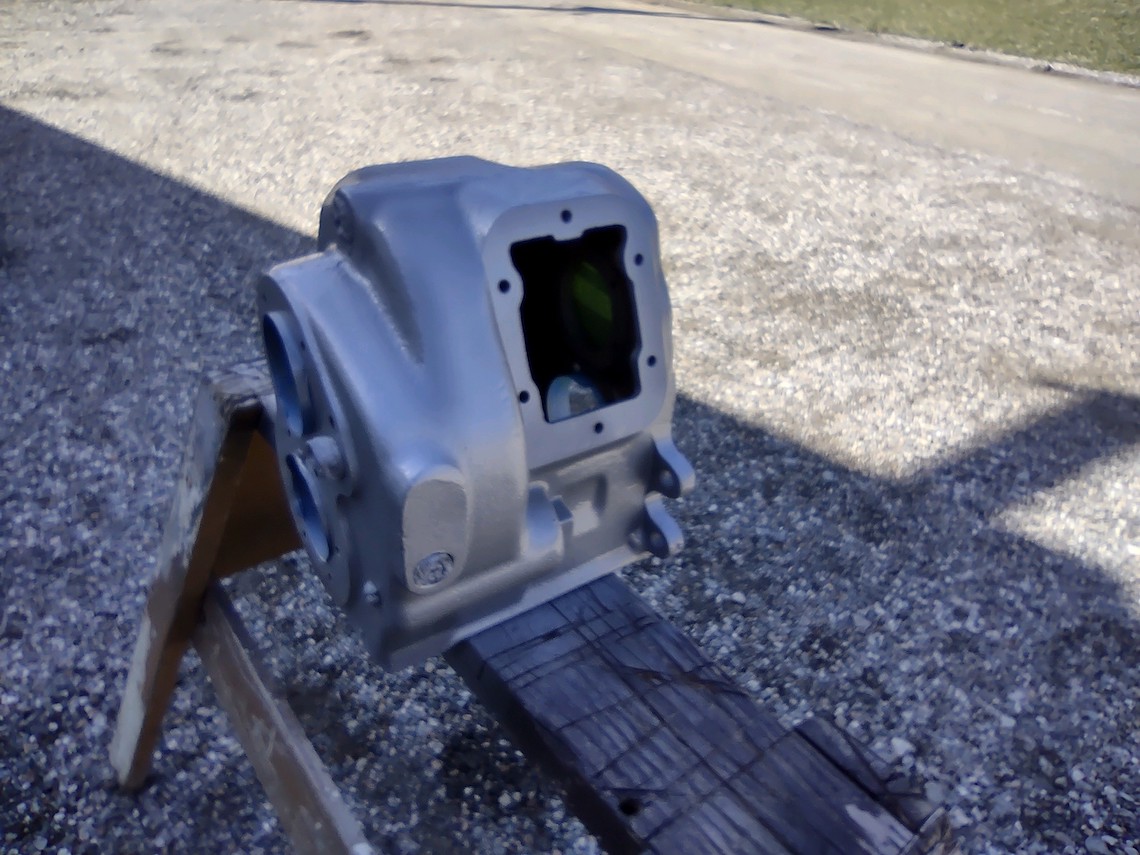

Transmission:
Transmission painted.jpg (217.69 KiB) Viewed 17303 times

Thanks Gary. Tim does some great work. I've been over "helping" a couple of times, along with my son. I suspect we probably slowed him down more than helped. First time I had ever sandblasted anything, so I was a bit slow at it.

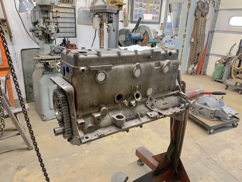

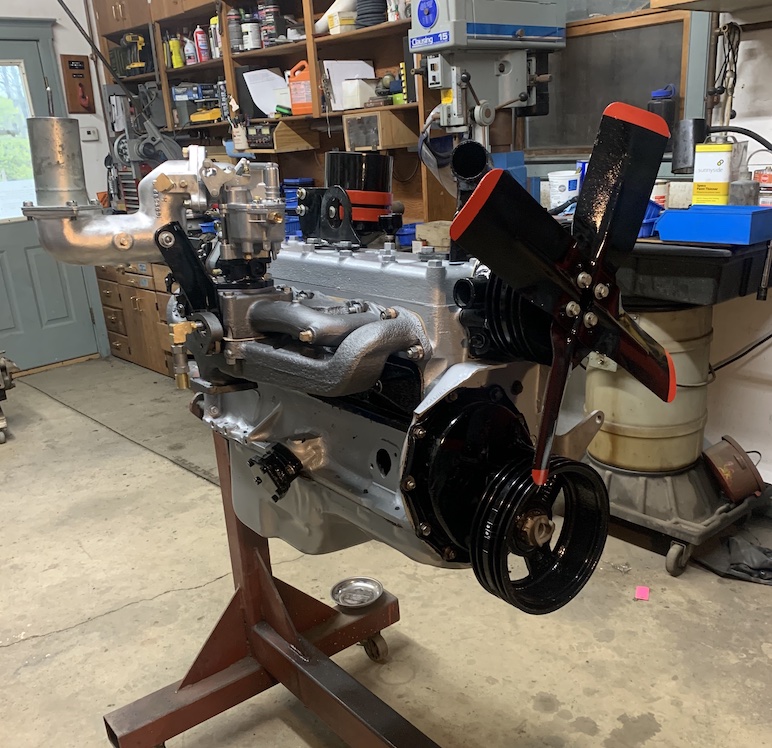

The 251 engine is going back together:
251 Engine assembly sm.jpeg (241.35 KiB) Viewed 17271 times
