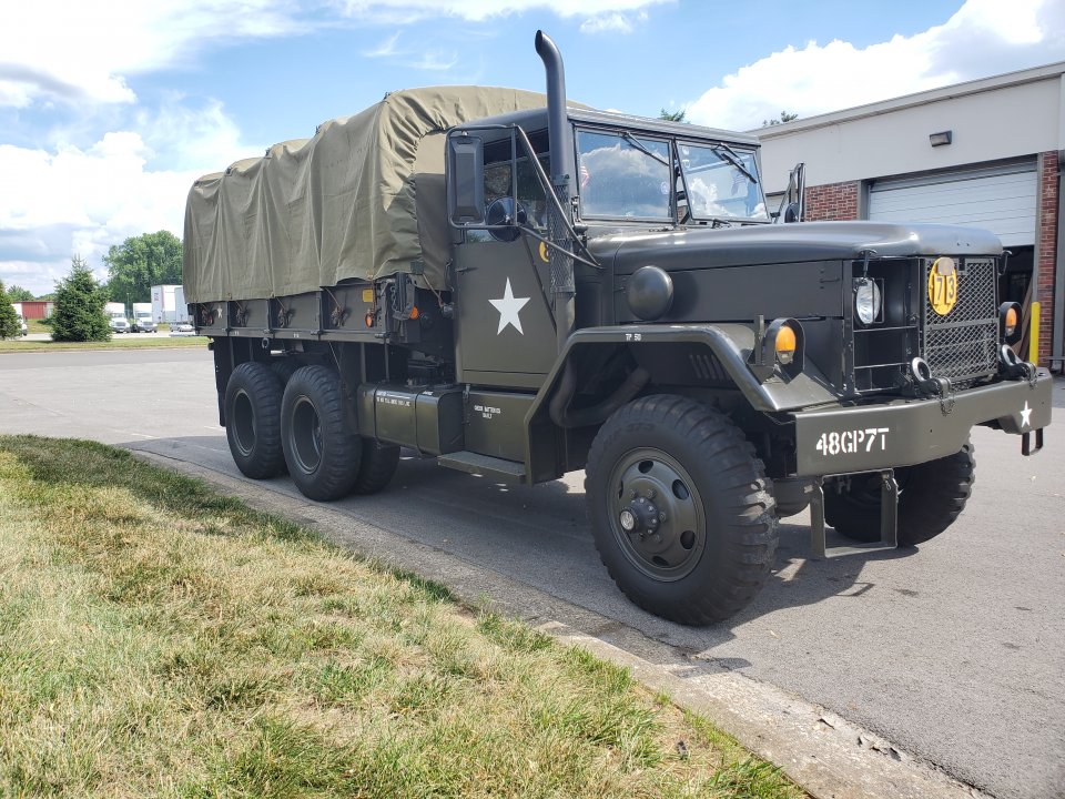

Many (including me) have gone to top-level latex paint from Home Depot brand Marquee.
A lot less toxic, and it looks perfect and lasts just fine.
Water-based easy clean up, too.
The M35 in the photo is not mine, just a good example of how it can look.
