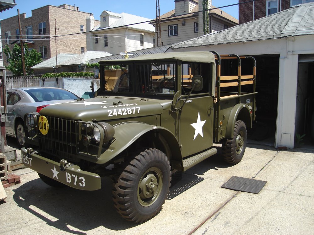

I believe I read over on Steel Soldier a while back that oak was used. I used Red Oak on mine only because I like the look of it .
1954 M37 WO/W
1969 M101A1
Re: Original Wood used for the Troop Seats
What an immaculate truck! I have spent two days de-mudding mine from the winch out episode of earlier this week. Hc
