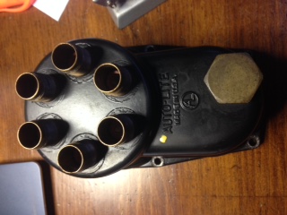

* Note the location of plug wire #1 on the distributor, if you look at the photo attached you'll see the typical position of #1. It's possible yours is pointed to a different tower.
#1 Tower typically next to Yellow Dot
* Pop the cap off the dizzy and check to see that the rotor is pointed to the correct location on the cap (you it located above), if it's not that's likely your issue.
* If things are not aligned properly you'll need to pull the oil pump and adjust as necessary to get the rotor pointed at the correct tower on the cap.
