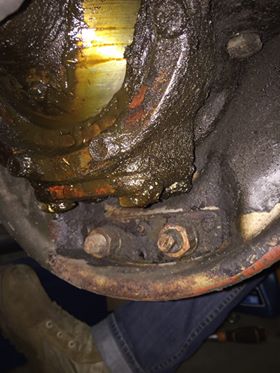

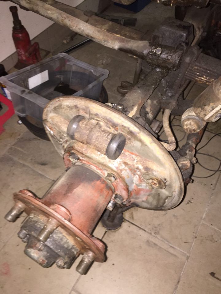

Im in the process of replacing my wheel cylinders and flexible brake hoses. Since I already took the drums and brake shoes off I thought about going further with this and stripping down the entire steering knuckles and hubs and replacing the seals and bearings. I can see that gear oil is getting into the knuckle and as far as I know it shouldnt sip past the seal like that, correct? I have bought a set of hub seals but I also realized that there is an additional seal and bearing inside the axle tube. Is this the culprit here? I want to be ready and have the parts on hand once I start digging into it. I only have time to work on the truck once in a while. How hard is it to pull out the seal? Do I need to replace the bearing as well? I would very much appreciate any advise on this. See below pictures of the knuckle, its caked with grease and oil and dirt. I will try o clean it once its disassembled.

If axle/differential lubricant is getting into the hubs (not unusual) then it's time to change the seals (500057) on the axle drive shafts. As with all seals, use modern, new production seals, not new-old-stock.mikeM43 wrote:Hello,

Having the parts on hand is a good idea, but that plan also depends on (a) how much wear and/or damage you find upon disassembly, and (b) how much you're willing to replace. I'd assume that the seals and bearings (plain and tapered roller) will need replacement, but you might also discover that the axle shafts are worn beyond the limits where they turn in the bearings, or that the Tracta joints are worn out (before lock out hubs were applied to many of these trucks, the front axles turned all of the time, even if the transfer case wasn't engaged for 4WD).
If you don't already have the three basic military manuals for this work (TM 9-8030 Operation and Organizational Maintenance; TM 9-8031-2 Power Train, Body and Frame; and ORD 9 SNL G-741 List of All Service Parts) I'd strongly suggest you obtain and review the relevant sections prior to starting this work. My experience has been that the printed reproductions are much better than the scanned digital on CD, which (at least the ones I have) either omit information, or reproduce some of the numbers and letters incorrectly.

But as the knuckle seals are clearly failing, hitting them with a pressure washer will force water into the closed knuckle, so once they're clean on the outside, opening them up should be the next step.

And as far as removal goes, I had to pull the center chunk on mine then drive out the seals and bushings from the opposite side using a 6-foot piece of pipe.

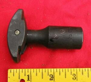

Rebuilding the knuckles is not too tough, just greasy!!!!
The puller I use to do them looks like:
Put that sucker on a large slide hammer and have at it. As far as install a large socket and extension work our you can fab up a bearing driver.

I believe that OTC (Owatonna Tool Co.) makes these pullers in various sizes. You should be able to buy just the puller(s), or the whole kit with slide hammer and plastic case, depending on what you need. They're available online from the usual tool suppliers (Tooltopia, Amazon, etc.)mikeM43 wrote:Thanks guys! You are very helpful! I will give it a try with a slide hammer and this puller if I can find it online somewhere.

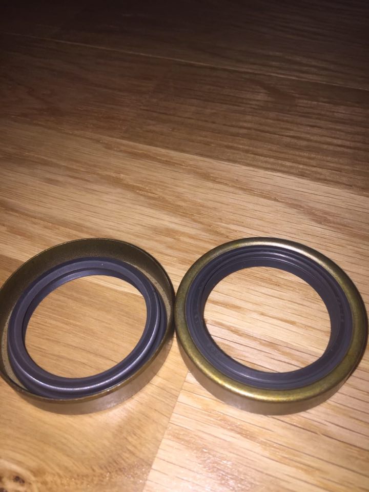

Its been a while since my last post but I didnt have time to work on the truck too much. Can you please tell me which side of the seal goes into the axle tube? I have bought a set on ebay and Im having a hard time trying to figure it out. Also when installing the seal and the bronze bushing do I tap them in separately or both together? Can I use a piece of pipe or a wrench socket to seat them in place? Thanks!

The spring side goes towards the liquid or grease that you want to retain. If the seal is used against a liquid, I usually apply a thin layer of some sort of sealer to the outside diameter of the metal seal body before installation. I apply a sealer even for grease, but it's usually not as critical.
Install the bushing, then the seal. If you try to drive the bushing in with the seal, you will probably damage the seal body.
As for a driver, I like to use something softer, such as a bearing race driver or a piece of PVC pipe of the correct outside diameter (cut square on the end!), but sometimes a socket is the only thing handy. Best to use a something with an OD close to the ID of the bore.
