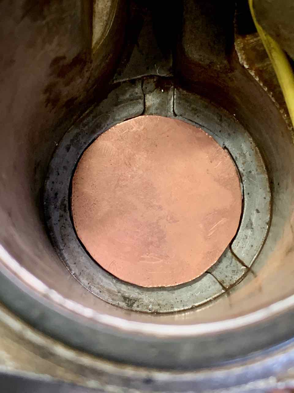

I had a similar issue on my M37 with the flat head 230.
I have the chrome Chinese coil. The dimensions of these coils are slightly different than the original US made coils.
Most of the Chinese coils are not as long as the US coils and may not bottom out into the distributor housing properly for heat transfer.
This can lead to over heating of the coil.
I cut a piece of .030" thick copper into a circle that fit into the recess of the distributor where the coil drops into. See pic.
My process:
1) Cut the .030" copper sheet into a circle that will drop into the recess of the distributor
2) Burnish the bottom of the chrome coil with green Scotch Brite.
3) Burnish both sides of the copper with the Green Scotch Brite.
4) Coat both sides of the copper circle insert with thermal paste.
this is the same paste used on computer cpu's and other electronic components.
5) Insert the coated copper circle into the distributor housing making sure it seats into round recess.
6) Insert the coil into the distributor and secure with the two screws.
Hope this helps
