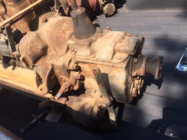

So I saw on FB a guy who was parting out a 63 USMC M37. He was going to scrap the original engine if no one wanted to buy it in a couple of weeks. I contacted him and ended up driving about 4 hours to pick it up. Well he had a winch as well from the truck. So I made a package deal. I ended up with the engine with transmission and PTO. The winch came with all the bits to be able to add one to my truck. :shock:
Winch and parts from the 63:
Engine and Transmission with winch PTO
