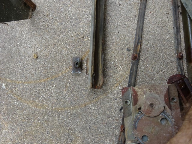

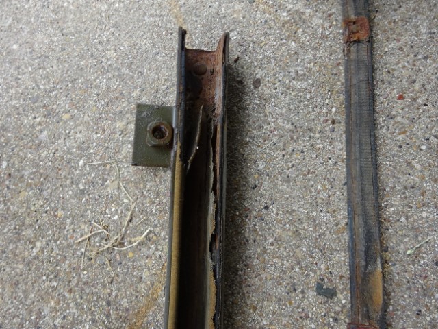

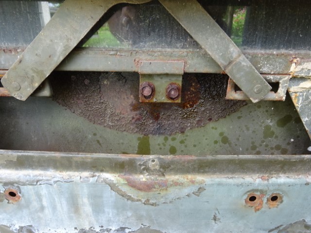

It's been a while, but I think there are four Phillips screws, two on either side, top and bottom. I think the access panel needs to be removed as well as the glass panel.

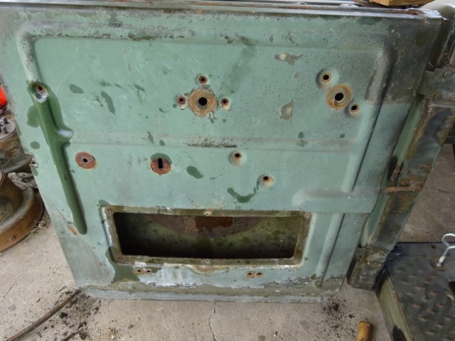

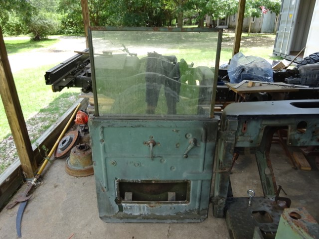

Re: door window felt installation (channel) weatherstrip
DSC01170 (Small).JPG (120.88 KiB) Viewed 2596 times
DSC01166 (Small).JPG (132.27 KiB) Viewed 2596 times
DSC01164 (Small).JPG (104.94 KiB) Viewed 2596 times
pics

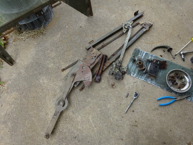

DSC01174 (Small).JPG (140.55 KiB) Viewed 2595 times
DSC01168 (Small).JPG (152.35 KiB) Viewed 2595 times
DSC01167 (Small).JPG (123.62 KiB) Viewed 2595 times
more

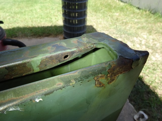

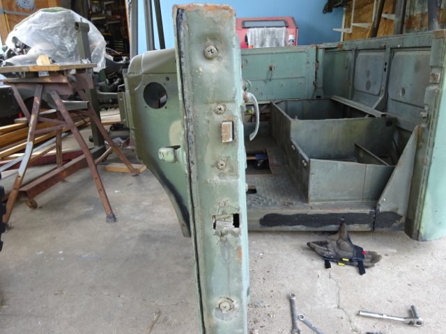

DSC01176 (Small).JPG (154.58 KiB) Viewed 2594 times
DSC01177 (Small).JPG (164.7 KiB) Viewed 2594 times
DSC01173 (Small).JPG (116.71 KiB) Viewed 2594 times
more.
Not too bad of a job, use a lot of penetrating oil, and use the right sized phillips head screwdriver(or socket). Now to round up the replacement parts!

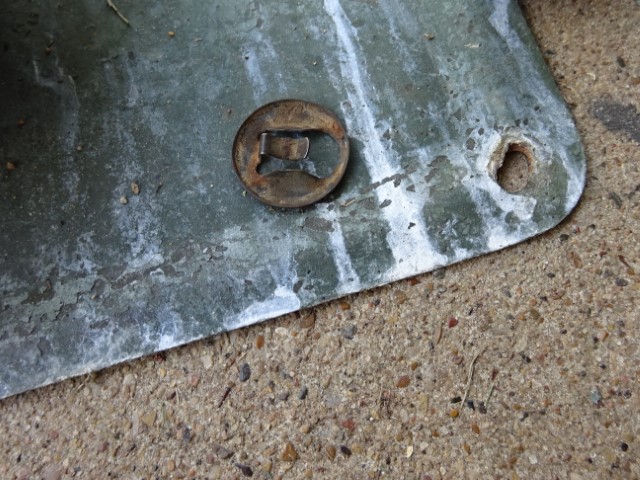

DSC01179 (Small).JPG (105.49 KiB) Viewed 2487 times
DSC01178 (Small).JPG (96.59 KiB) Viewed 2487 times

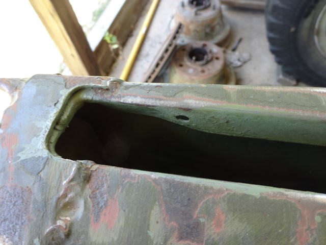

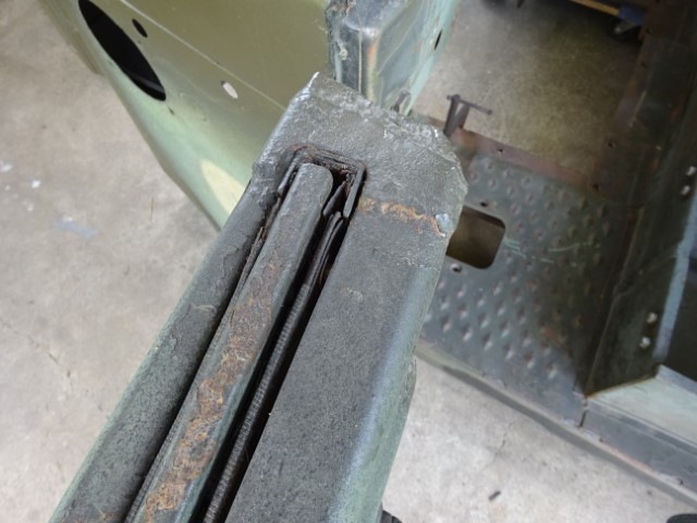

question about edge. Should it be bent back like these are? I don't think so, anyone know?
back to the bent edges. (see last two pics) Both of my doors have the ends of the lips that the window wipes attach to bent away from the opening. This seems wrong, but maybe it is right?
Need some opinions!
They both look right to me?
