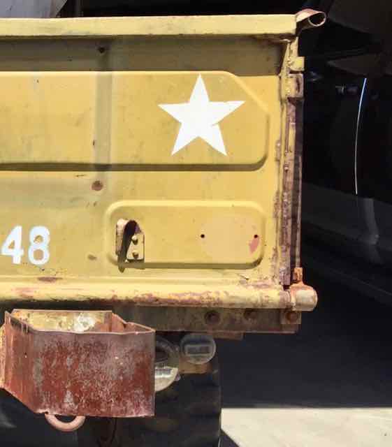

Re: M37B1 passenger taillight & blackout light.
Hope this helps. My '63 m37.
- M37 rear light.jpg (8.85 KiB) Viewed 2828 times
- M37 as purchased.jpg (24.3 KiB) Viewed 2828 times
outpostm37,
Thanks, that is the front of what I'm looking for. Now if you could get a couple of shots from underneath showing the mounting hardware/bracket that would tell me how much I need to fabricate.
