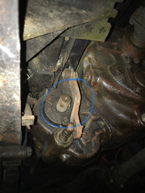

Regardless, I am thinking now that I can get a machine shop to make me a 2.5 foot shaft that connects the back facing PTO shaft and coonects directly to the hydraulic pump output shaft. The PTO is 1.125" with a .25" keyway and has a retaining pin/bolt boring through it. The hydralic pump dimensions can't be much different. I won't use universal joints, gears or chains, just direct drive bolting the hydralic pump to a neoprene base to reduce shock. This ought to work and be a lot cheaper.....right?
Uploaded an image of the backward PTO shaft. I have read these are rare and I have noticed only the single direction PTO is mentioned in my manuals.
I just assumed that because this truck had the front and rear PTO output shafts that the back facing shaft was used for the welder (front to winch).
- 7E908DD8-FCF7-412F-B3FF-73A505AFFA24.jpeg (231.43 KiB) Viewed 4860 times

You will want to use Lovejoy connectors to connect the pump to the shaft since you can never get perfect alignment from shaft to pump. They will absorb slight differences. You can also go from one size shaft to another if need be using them.

the dual output PTOs is what came on Power wagons. nice unit. I would run ujoints because the dodge frames flex alot (on purpose) and the parts are standardized and available at any driveline shop. in fact if you figure out the shaft sizes and length you need you might find a universal driveline kit off the shelf that you cut to length,. I have done it that way before.
